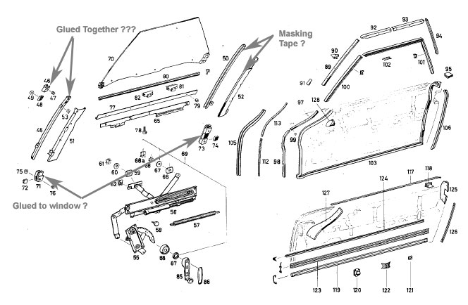

As I removed my side window along with the window "transmission", guide rails, etc...  I have several questions...
Please refer to picture:
1. On my window, the upper chrome guide jaw is glued to the upper guide rail.  Is this correct?  Should it be gluded?
2. On my window, the 2 lower guide jaws are glued to the bottom of the glass.  Is this correct?  Should they be glued?
3. On my window, there is a piece of tape (masking, linen type tape) between the rear guide rail and the water trough.  Should there be tape between these pieces?  Maybe done to reduce vibration noise?
It seems to me that the plastic jaw inserts, along with the small stub screws would be enough to hold the side windows without any add'l glue?
Thanks for the clarification on these questions.

Q1 & Q2: Yes, the jaws can be glued to the window to keep them in place for a longer time. But even then they tend to get loose with time.

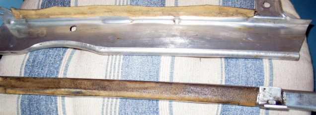

Q3: Yes, there is a linen/cotton strip glued to both sides of the water channels.  I replaced the strips with waterproof bandage tape bought at a drugstore.

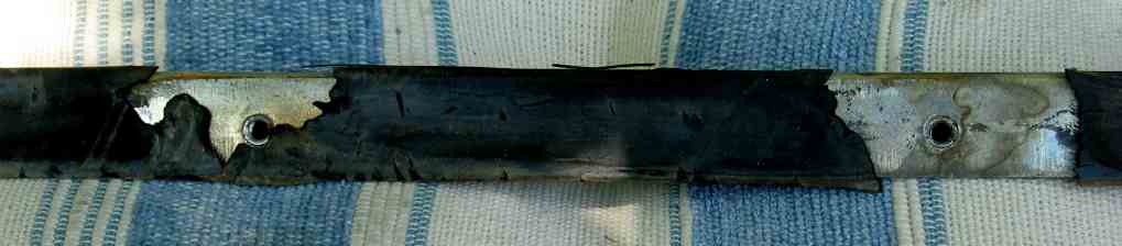

You should also take a look at the bar (#77 in your picture) that holds the window glass and replace the rubber strip that acts as a "cushion":
1.Yes, the top front jaw is glued to the glass rail.
2. Yes, the 2 lower jaws are glued to the glass,with the linen type tape in-between, I guess to make a tight joint.
3. No, I believe there should be no tape between the glass and rail, or guide rail and water channel.  :oops:  (See Alfreds pix)

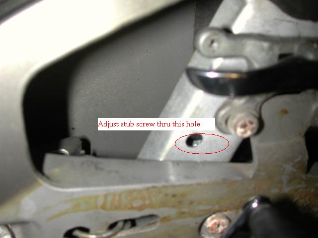

The plastic jaws do not hold the glass to the jaws (if you do this and tighten the screws, the glass will shatter - don't ask how I know!!): they slide up and down the rails and the stub screws are used to adjust the play between the jaws and the rail so the glass does not rattle.
The stub screws should be toward the inside of the door when refitted and there are holes in the water channels thru which the screws can be tightened/loosened to adjust free movement of the glass without rattles.
Download Attachment: DrGlass008.JPG

the linen/cotton strip is between the water channel parts to prevent rattling, it does not touch the glass.  At least that is how the channels looked on my 230SL when I took them apart.

(1) I would not use double-sided sticky tape because you do not want the rubber to stick to the glass also. Of course, after 40 years the glass is now baked onto that rubber/vinyl strip and hard to separate.

When I replaced the rubber strips I wanted to match the thickness (about 1 mm) of the original strips since I wasn't sure how wide the slot is in which the window travels. Also on one side the rubber was ribbed to give it a bit of grip and for this reason I used a similar grip material that I bought from Grainger, see photo. The lower item is a single-sticky tape (0.75 mm thick) and you need two of them. Unfortunately I have nothing left but do have some of the grip mat on top.

I used a bicycle inner tube for the rubber strip, just cut to size and glue
onto the metal bracket. Works great.
