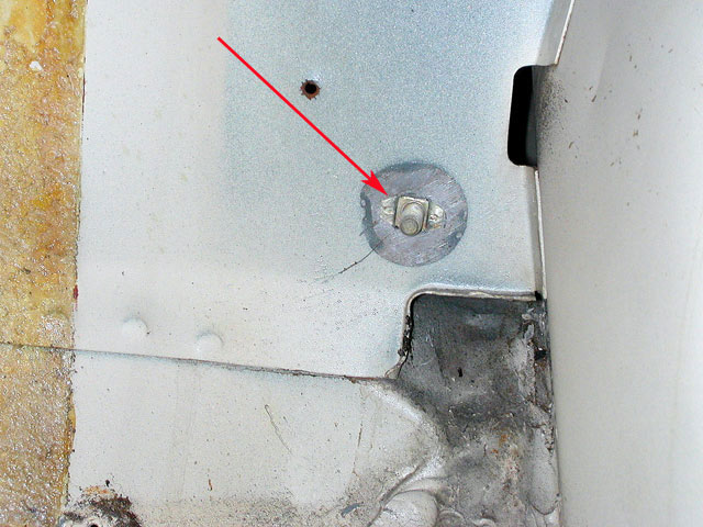

We always seem to focus on the famous open paintless area that resides under the radiaitor overflow tank (ground location).
As I took apart my car for the upcoming repaint, I located many more ground locations that I wanted to share.  This is important to help resolve electrical ground issues...
Below Overflow Tank & Under Aux Fusebox Bracket
Download Attachment: EngineBay_ab.jpg
62.64 KB

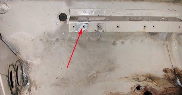

Firewall (Main Engine Ground)
Download Attachment: EngineBay_c.jpg
72.85 KB

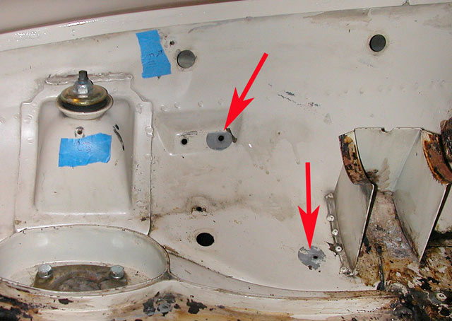

By Windshield Washer Pump (on body post)
Download Attachment: EnginBay_d.jpg
38.29 KB
