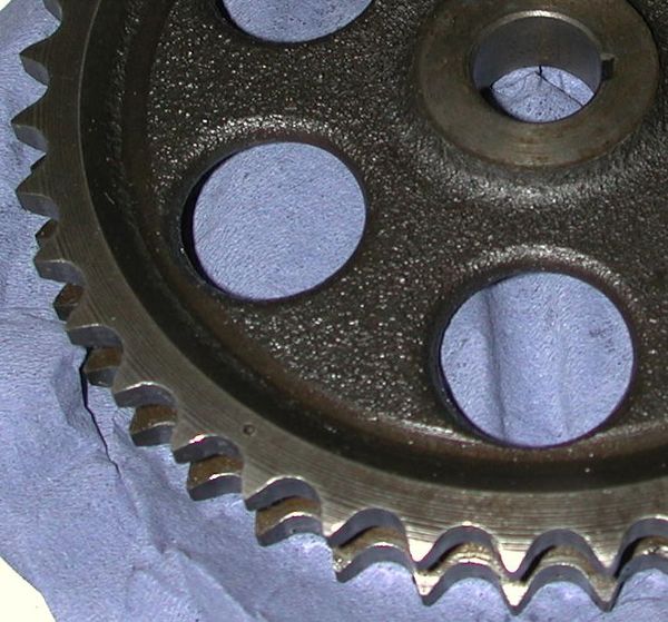

When the timing chain broke on my 230, I had a mechanic friend replace all the sprockets and chain. He got it back together alright but the distributor was in the wrong place when I got it back. I just removed the distributor at #1 TDC firing stroke and turned the gear until I had the drive slot roughly where I wanted it and put it back. Worked fine!
I believe the sprocket that came out of the engine is original and has a punch mark at 4 O'clock when the key slot is at 12. Seems original rather than one made later on, but I could be wrong?

Apparently you were able to get a satisfactory distributor position just by rotating the drive gear, which is easy to do as I mentioned.  I wasn't able to, because I didn't have 40 degrees of clearance to play with.
Your method of rotating the distributor drive by 180 degrees hadn't occurred to me, and it's clearly far simpler than mine -- thanks for the tip (and for the info on the sprocket).  How hard is it to drive out the pin and reinstall it?  For example, do you need to heat the collar to do it?
