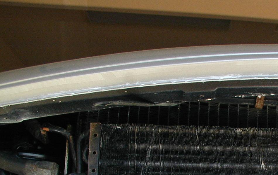

I will try and import photos to show that my a/c condensor is about 2 inches narrower on each side and also not as tall as the radiator, therefore there is no place to screw onto, other than directly into the "fins" of the water radiator.
What is wrong here????

Re: Installing Oil Cooler ??
« Reply #8 on: October 16, 2003, 21:14:35 »
My car doesn't have a front mounted oil cooler, but perhaps you can have tabs soldered to the sides of the frame to align with mounting points at the radiator?  Just a suggestion.
