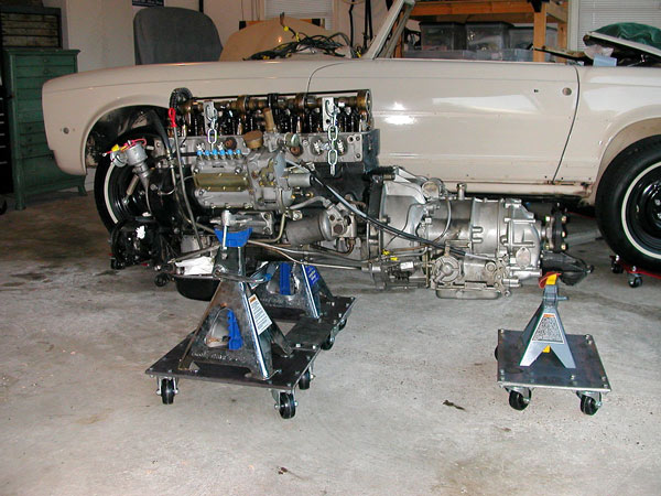

With your GREAT ideas, what I am going to do is use 3 car jack stands and under them have a heavy duty metal plate with heavy duty rolling casters (x4 per plate) that I purchased at Northern Tool.  My son works with a company that can supply and cut some nice steel plates.  I will take a pic.

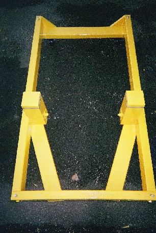

3 car stands on a heavy duty metal plate sounds good. I made a wooden version of it by 2x4 on wheels (two stands actually, both for engine + transmission).  The oil pan is barely clearing the floor, but they are easy to move around. I have added a couple of pictures of them just when they were completed. Good luck!

Thor, your stand looks very nice!  You even painted it!
My son and I made our rolling stands out of 3/8 inch steel plates and swival casters each rated at 250 pounds.  We went to my sons place of employment and were able to find some scrap steel.  Then my son went to the "chopper" machine and he cut the plates for me.  We made 3 of plates, each with 4 casters.  One plate for each side and one for the rear.  On these plates we used standard jack stands...
If we were to do it again, we would have only made one larger plate for the front, because we ended up having to cut a couple of additional pieces to hold the front plates together.  After we set the engine on our home made rolling stands, we tested it and found that the front 2 stands started to rotate as we moved it, and with the angle of the side engine mount arms, we got a bit nerveous that the jack stands would slide out...  So we tied the 2 front plates together...
