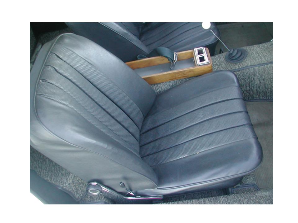

Here's a pic of my '64 230sl (#1515) with the original carpet: it has a rubber grommet around the boot (the grommet is attached to the carpet (glued) and fits snuggly around the shifter boot.)

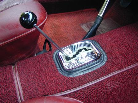

My '66 looks like this, I'm reasonably sure it's original:

Originally posted by Bob G MN
I have an origunal carpet with automatic and it is the sme as Paddy's picture.  I think the standard shift had a rubber grommet
See, this is the problem — Paddy's carpet is different. To my eye, it looks like the trim from the sides of the carpet has been used for the gearshift surround as well. It even looks to be red and not black.
I'm not positive, but I think Paddy's carpet is old, but not original. Take a closer look at your carpet, Bob. I'm curious to see what you find.
It just doesn't make sense for Mercedes to have a part, then use it sporadically. They were remarkably consistent.
Achim, can you add anything here?

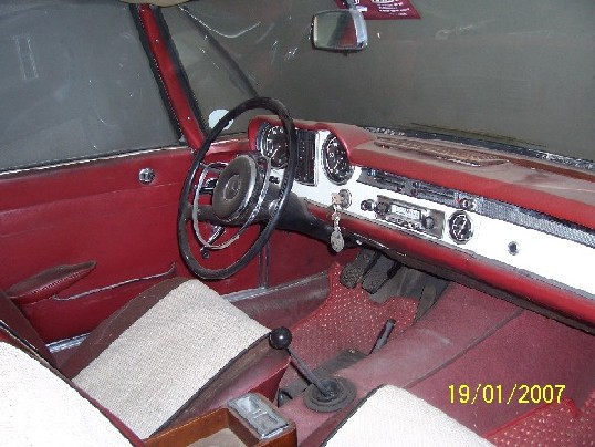

This is mine, surely original:

Douglas,
Mine is trimmed the sme as Paddy's except the trim  is black but then i have a grey/black original carpet.  I know it is original as I've has the car since '67. The car is a '65 230 SL. His trim is red as it would  have matched the  carpet.
Is the trim black around the gearshift? Looks that way in the photo.

Douglas,
I think that standard shifts used the reubber grommet and automatics used the carpet with the border.
