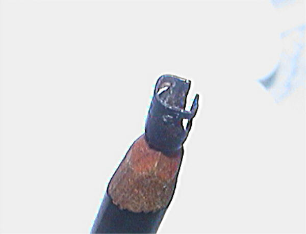

I just so happen to have a couple of the spring steel clips that hold the side vents in place laying around.  Here's what it looks like
Download Attachment: Bob 003.jpg
19.18 KB
The clip is cylindical with an expansion slit running on one side.  The top of it is a little wider than the bottom.  It is placed in a hole in the dash.  As the pin from the side vent pushes in it expands against the dash hole.  The compression created by the clip, pin and dash hole keep the vent in place.  You will be able to see one of pins/clip in place when you remove the tach at about 7 or 8 o'clock on the underside of the dash.  I would start with this one and try to gently pry the vent from the front while pushing the pin from inside the dash.  The only way I know to remove it is to wiggle the vent gently back and forth a little at a time until the pin that pin pops out.  With that one out the rest of the vet is a little more free to wiggle and the second pin should come out,  Just gently pry from the front whilee wiggling the vent back and forth.  Takes time but it will come out>

Thanks!  I got 'em out!  I used alittle "Deep Creep" on each pin.  With all the dash pieces out, I was able to lay on the floor and look up into the dash.  I then used a hole punch and carefully tapped on the rear of the pin.  It finally popped out!  No broken pins...  I then used a pair of pliers and pinched the spring clips and removed and bagged.
Your pic and post helped!
