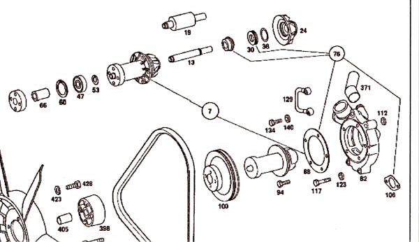

The rebuild kit for the water pump is available from MB for $23.00.  It includes two gaskets and 2 seals which go inside the impeller.  I thought once the bearing was out I could purchase a replacement from any bearing store.  That's pretty much it unless the shaft is messed up.  I think I can find someone locally to press the components apart and then reassemble.  Before I did that I thought I would ask for experience from others that have replaced theirs.  That certainly seems the cheapest way to go.

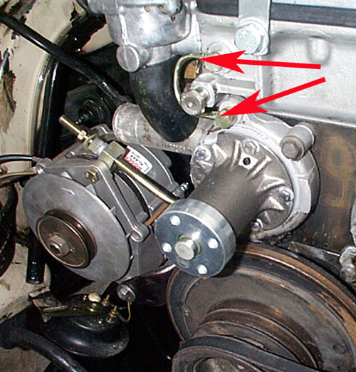

If you need a new water pump, there is a shorter version for A/C cars, and a longer version for non-a/c cars.  Refer to attached pic. It shows mine, the longer version.  If you do the pump, also replace the small half circle tube that connects to the head and top of pump (also new washers).
Sorry to hear about your issue.

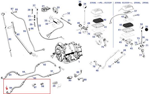

And looking at this explosion from SLS, I would want #53, and the circular vent #60 and washers #62?
Also I noticed coolant around this connection #84. I suppose I should replace it at the same time?
