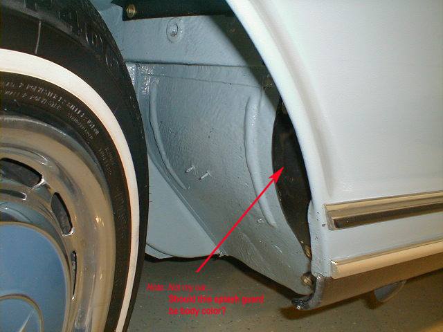

1.  Were the front inner wheel well spash guards painted body color, or were they left gray or black?
Download Attachment: splash.jpg
79.24 KB

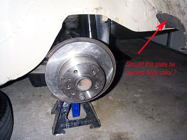

2.  On the later models that had the vapor tanks in the trunk, was the metal safety plate on the driver side rear wheel well painted body color?
Download Attachment: plate.jpg
79.23 KB

You're obviously not going for Concours originality so do what makes you happy.  My wheel wells are painted body color, front and back.  I don't think the appearance would benefit from the contrast being visible in the front.

At the risk of prolonging this thread. I believe the first question you asked about the front wheel should be left as the photo you have posted. The wheel well inner color is body color, but the splash guard should be black/gray.
I have an earlier car with the small vent tank in the right rear inner fender, so I can't do an exact comparison on the second question. Mine is all body color.

Additional colors used on W113 vehicles:
Kofferraum innen: Tiefdunkelgrau, DB 164 Trunk inside: 164 dark grey
Heckdeckel innen: Tiefdunkelgrau, DB 164 Trunk lid, inside: 164 dark grey
Radkasten: Wagenfarbe UT Wheel wells: body color
Schweller: matt schwarz DB 169 Rocker panels/Sills: flat black 169
Source: http://www.sl113.org/wiki/pmwiki.php?n=DataCard.PaintCodes
