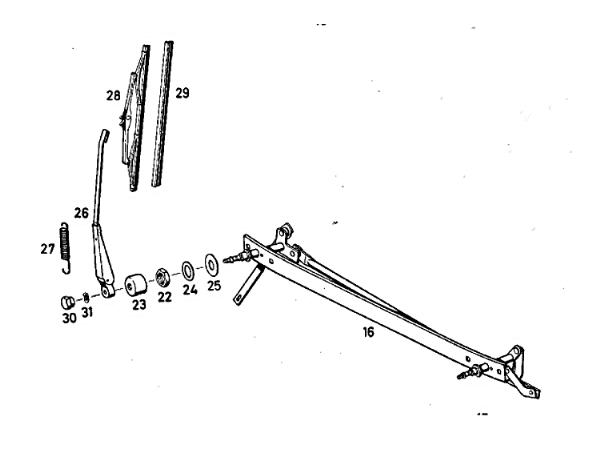

Both wipers are controlled by a sigle motor which is located on the passenger side firewall.  There is a long rod that connects the two wipers shafts to the motor.  I would say that the drivers side of that rod has somehow become disconnected from its wiper shaft.
Here is a pic of the assembly.  The only way to know for sure is to take a look at the rod.  Its easiest to look at it from the passengers side by removing the glove box.  From the opening you can inspect the rod as it is connected to the passenger side wiper and motor.  If it is broken at the drivers side you will need to remove the tach to inspect the problem.
Depending where and what is broken will determine what to do next.  Worst case will require significant disassembly of the dash board in order to remove the entire wiper assembly for repair.

The cross over link that connects the two wiper shafts together usually becomes disconected on the right side behind the glove box.
the reason they come apart there often is because the left side wiper shaft has become stuck and wont turn any more.
I came up with a set of tools that I used to free up stuck wiper shafts that didn't involve the dismantling of the entire dash board.
