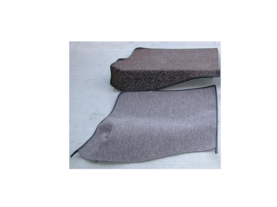

My '64 230sl came with a 116 interior which has black MB tex upholstery and a kind of salt-and-pepper weave carpet. Unfortunately, no one makes this color/style carpet anymore, at least I couldn't find any vendors after three months of searching. I've attached a pic of the original carpet (on the decks) with my replacements (gray from World Upholstery.) I opted for the gray to add some contrast to the black upholstery in the cockpit.
I think MB may have changed the color mix of the 116/caviar interior at some time and discontinued the salt/pepper look.
Steve

Your original carpet sounds like what I have.  My carpet is in pretty good condition given it's age, aside from where it was glued onto the transmission tunnel (don't know if it was PO or factory??, but imagine PO).  That got torn a bit when I had to remove the carpet to replace the shift bushings.  Probably will retain the carpet until it becomes more of a problem.
