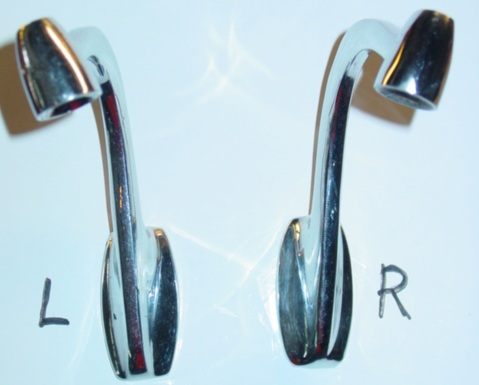

Re: Right or Left Side Mirror for 230SL
« Reply #6 on: October 04, 2007, 06:58:30 »
oops
I am dyslectic (not joking) so left and right is an intangible concept. ;)
Here is a photo to help clear things up (I hope)
When we owned our shop 25+ years ago my brother ran the parts dept and he would buy boxes of returned and overstock items for cents on the dollar from MB dealers, one box had about a dozen assorted mirror posts for early and late sedans and SLs the right handed one was the only one I had ever seen for a 230sl. Now they are being reprodued and it seems every car on Ebay has a pair of right and left mirrors.
