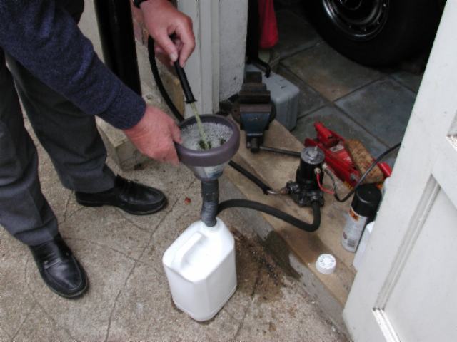

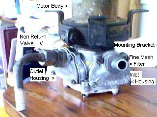

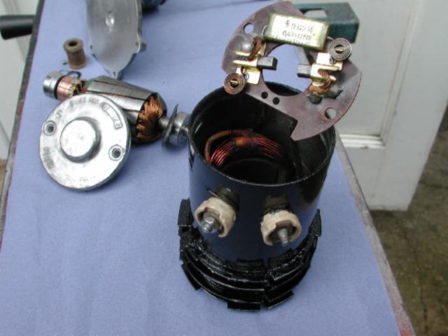

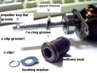

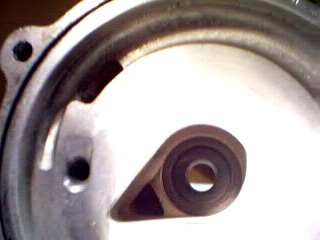

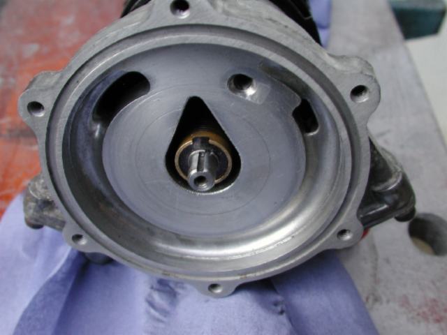

here are the pictures I tried to upload to the wiki Manual.
How do I add pictures to the wiki manual?
Any advice welcome

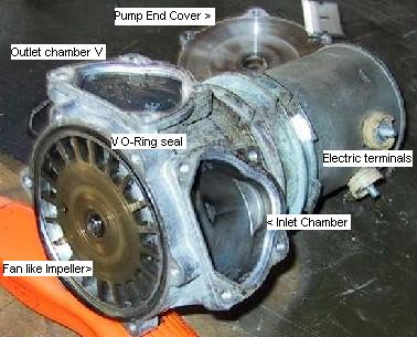

Hi, Bob,
Looks good now.
I'm adding these pix. Hope its OK?
Download Attachment: EFP_Brush_Plate.JPG
36.18 KB
Download Attachment: EFP_key_Slot.JPG
34.45 KB
Download Attachment: EFP_Test.JPG
40.93 KB
Download Attachment: EFP_Impellor.JPG
37.18 KB
Download Attachment: EFP_Small_Pump.JPG
39.06 KB

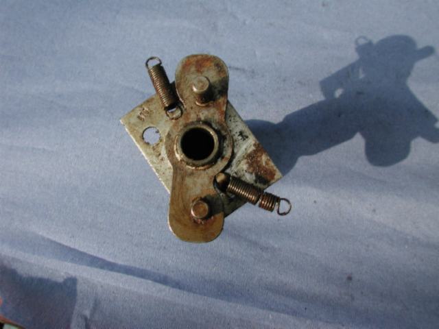

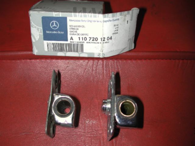

Download Attachment: 230SL_Autobooks.jpg
46.33 KB
Download Attachment: DrLatch001.JPG
38.45 KB
Download Attachment: DrLatch002.JPG
38.03 KB

Download Attachment: 230SL_PumpID.JPG
35.5 KB

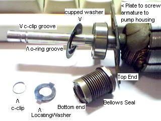

 :?: This is a usefull thread wiht great Pics.
I stripped and cleaned out my pump from 20 years of standing. It works fine but pushes out fuel fuel form the overflow. I started my car with the overflow leaking into a gallon.
Were can I get repair parts? It is a 230SL with the long type of pump.
Brushes
Bellows
O rings
clip that holds the belows
Seal that the bellows sits agains (one of Naj's pictures shows this)
Thanks everyone. This is a great forum.

Have a look here for the fuel pump article:
http://www.sl113.org/wiki/pmwiki.php?n=Main.FuelPumpRebuild
Bob has given dimensions and part #s for available items.
The bellows, clip etc. are no longer available. You may have to look for a 'donor' pump if thease items are not servicable.

Hey Haj,
The brushes and testing pics will complement the others nicely.
I am going to remove my name from the Tech Manual article so that NO One person gets credit.
The collaboration makes a great piece of information.
