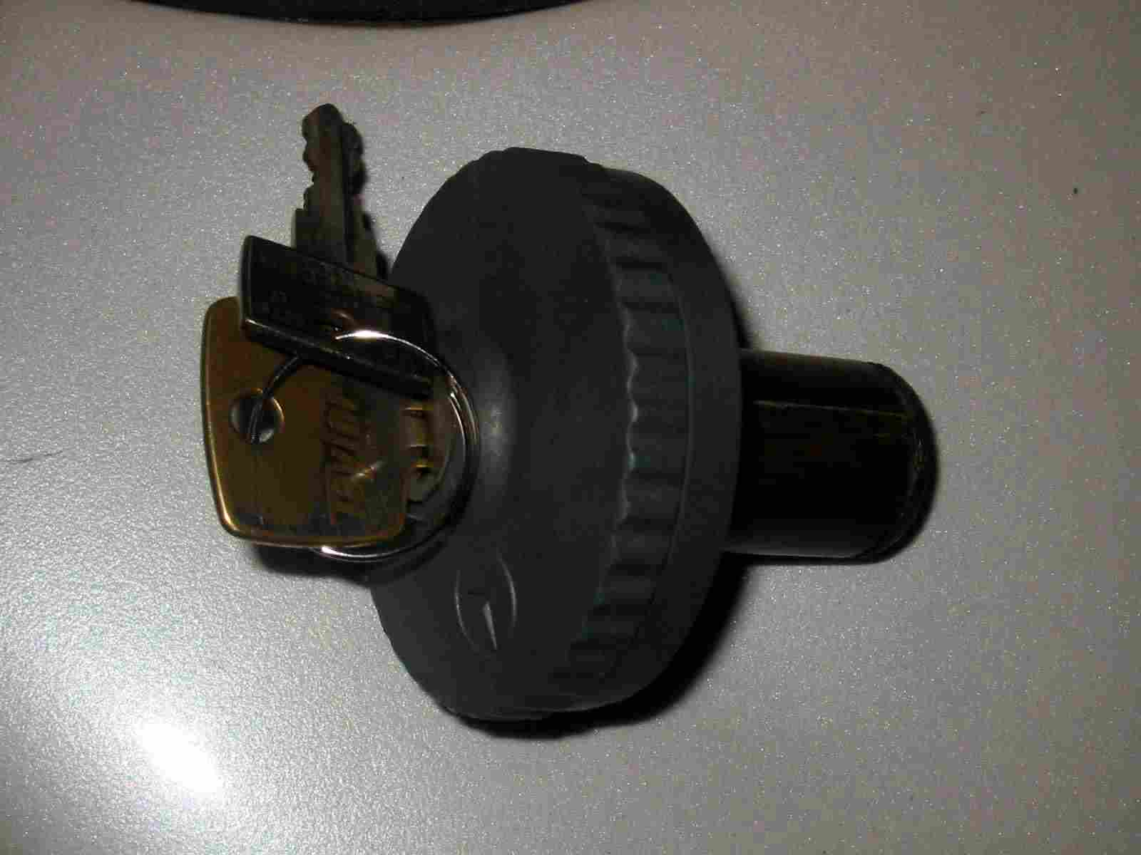

I found a gas cap from a 71-280SE, very nice. Before I send it to the chorme shop I gave it to a local ocksmith to change the lock to fit the ignition key of my 280SL. Unfortunately, the locksmith could not remove the mechanism. I tried another locksmith with no luck.
Does anyone ever dealt with these type of locks?? See photo.

Use the search function.  Someone recently did a whole tour of a cap dissassembly including photos.  You can do it yourself or take the photos and text to a locksmith.  However, are you sure you can fit the length of an ignition key into the cap?

In the photo, the key in the lock is from the 280SE ignition. The other key is from my ignition. My key goes all the way into the lock but will not turn it. The locksmith assured me that he can change the pins in the existing lock if someone can take it apart. The cap comes from a junked car ($5.00). The local chrome shop will charge $50 max. Although not OEM, it will still look better than the plastic one in my car now.

Sorry about that, but it won't work with the sedan fuel filler cap you found.
Yours is already a later style cap - Huf or Ymos - used on e.g. sedans like W108, W114/115 and so on. It's not correct for our SLs.

There are no numbers stamped on the cap. I do however have the key from the 280SE that I can use (shown in photo). No doubt the cap is not correct for our cars, but it fits perfectly. It is usable as it is, but would like to have it chromed and to work with my ignition key. If the lock cannot be changed, then how do I get it chromed without taking it apart??

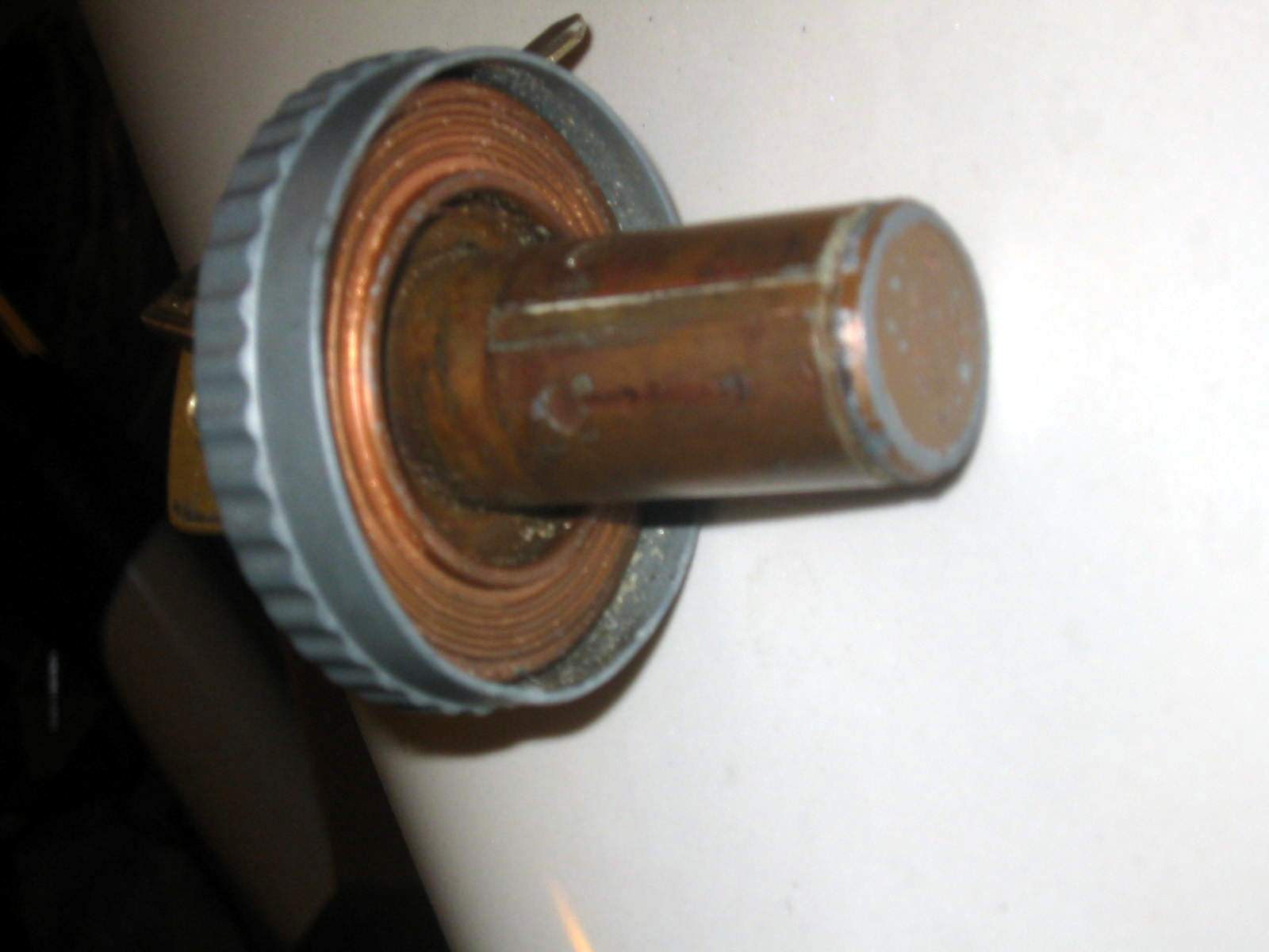

I did check the link and also searched this site. Although the cap itself is exaclty the same as the one shown on your link, the cylinder on my gas cap is very different.  No 3mm holes. It looks that mine is pressed into place, because there are four oval marks leading me to believe that this is the case. Thank for your help though.

Here is the photo of the cylinder. You can barely see the oval press points.  I have already taken out the lock ring and spring.

Hey Harry,
I can see a round mark on the side of the cylinder.
MB must have decided on a 'replacement' concept for the Gas Cap in lieu of changing keys.
What does that coiled spring do?

The coiled spring holds the ring that latches to the neck of the gas tank.  On top of it fits a cover that in turn is held down by the clip that sits on top of the cylinder. I have taken these prts out already before I took the lock to the locksmith.
The oval press points or dimples appear to be the areas where they pressed the cylinder in place. No way to take it apart.
Thanks for your ideas.
