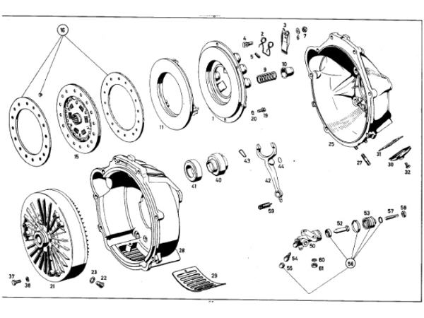

I'm not sure I understand the question.  Are you speaking about a manual gearbox with clutch or an automatic transmission?  I'm familiar with the manual transmission and attached you will find a couple of pictures of a manual or 4 speed.  The clutch picture shows the flywheel in the lower left corner.  The other picture is the transmission or gearbox.
If you can have you mechanic identify the part that he thinks has failed maybe it will help us understand your problem.  Many manual transmission parts are interchangeable from model to model.
Download Attachment: Clutch.jpg
