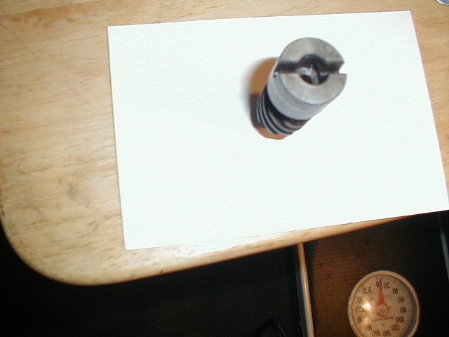

You will need to re-set the distributor from scratch. Set the engine at TDC compression stroke #1 cylinder. Remove the oil filler cap and make sure the front two cam lobes are pointing upwards (10 o'clock and two o' clock over the first cylinder). The crankshaft pointer should be set on Zero. Remove the distributor cap and ditributor.  That slotted gear below the distributor can be removed or repositioned. First there should be a small spring on the top of the gear, (look with a flashlight). Remove the spring then take a large slotted screwdriver and turn the gear clockwise, it will rise and fall back into place at a 40 degree different position each time. Notice the top slot of this gear is offset very slightly. The distributor is meant to engage the gear only one way.
Download Attachment: offset  slot.jpg
57.2 KB
Do not force it on 180 degrees off! The distributor orientation for all except the later replacement aluminum units should have the vacume cell at about two o'clock and the condensor at about 9 o'clock. Looking down on it facing forward. Turn the distributor drive gear in 40 degree incraments until this correct orientation is achieved. The rotor should now be pointing to the slash on the distributor rim (designation for # one cylinder spark plug wire). Dont't forget the little spring and always push downward on the distributor when locking the distibutor down. Otherwise the little spring will push the distributor upward and disengage it. Take a look at this photo of the gear and the little spring(often missing!)
Download Attachment: Distributor drive gear.jpg
50.24 KB
Also see the slight off-set of the slot in the top of the distributor gear (photo).
When the distributor is oriented correctly you should have plenty of room for adjustment. If you need more details or photos let us know. Good Luck!

I would like to thank Joe Alexander for his contributions to this group.  I have been installing the Crane ignition unit in my 1970 280SL.  I took the distributor out and took it apart to clean it.  I did not realize that the bottom fitting was offset.  It is very hard to notice.  Anyway I reassembled the distributor and installed the bottom fitting by reinserting the locking pin.  I tried to reinstall the distributor and could not get it to seat properly.  After reading Joe's post I realized that the bottom fitting was reinstalled 180 degrees from where it should be.  The distriobutor would not line up with the bottom gear fitting.  Needelss to say I punched the pin out, turned the fitting 180 degrees and was in great shape. One must read Joe's posts very carefully.  There are years and years of lessons learned and knowledge to be had.  Take the time to read and digest what he has to say and you will solve your problem.
