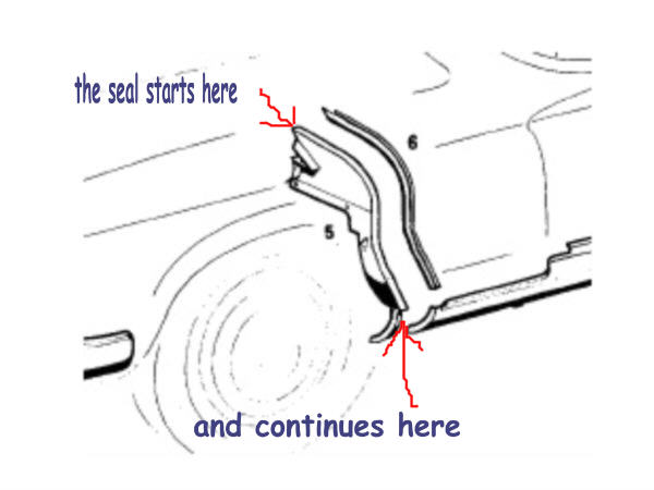

Hi thanks for the info got new weather strips,but it looks like there should be a rubber bung or seal at the top of the removable panel as there is a gap at the top of the panel?. Cheers Mike Rutledge

Mike,
The rubber seal runs from the rocker panel along the inside of the fender and across the top of the fender to form a pretty tight seal.  There should be no gaps.  See the attched pic.

thanks everyone. the part i mean is at the top end where the rubber strip ends its shown on the parts catalogue part no 113 884 00 91 it seems to fit over the trunion and continuing from the end of the rubber strip  Regards Mike

Mike,
Having a hard time understanding where you mean.  Part # 1138840091 is listed as a seal that is no longer avaiable so that doesn't help either.

Hi Jef.Sorry I wasnt that clear,its hard to explane.The gap is where you wrote,the seal starts here on the sketch you sent me,if you run your hand on top of the trunion under the fender to where the seal starts here on the sketch there is a gap where the seal ends,I was told to get in touch with the old timer centre in stuttgart i will let you know how i get on. Cheers Mike 66 230

Hey Mike,
I should have just looked under my car to see what you were talking about.  I certainly don't remember the gap you are referencing, but it is there.  I have no idea what if anything goes in that space. I have not taken the wheel off to examine the area closely but any water which goes into this space may find its way under the front cowl and wipers and be drained from that area through the small tubes under the dask and out through the fire wall.  Just a thought.
