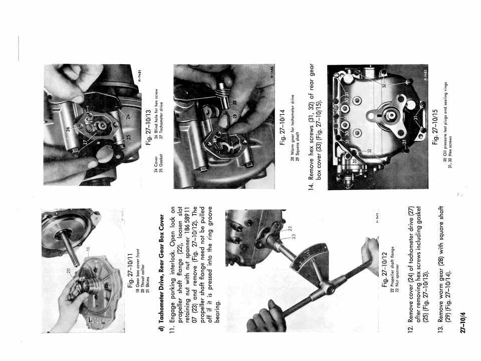

How hard is it to replace? I took a picture of one of Joe's old transmissions showing the clamp and the gear assembly and it looks like that you'll have to remove the tranny to get to it.
Download Attachment: SpeedoCable.jpg
74.82 KB
Part of the job is described here [note: "tachometer" in German = "speedometer" in US English]:
Download Attachment: TachGearRemoval.jpg
64.67 KB
Good luck!

The speedo drive number and the pics posted are for an automatic.
The rear cover on a stick shift car has thrust shims behind it that hold the transmission gears in alignment. Once the transmission tunnel plate is removed to get the cover off, it wouldn't be a whole lot more work to pull the trans completly out. then you could do the work on the bench where it is easier.

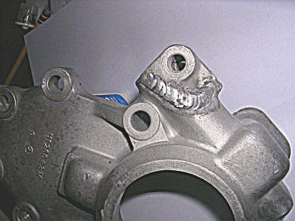

SLS shows the part is available at 165 euros.  Their number is 226225 and the MB part number is 111 260 04 16.  I broke mine and had it welded as shown in the pic.  It's aluminum btw.
Download Attachment: Cover trannya.jpg
67.34 KB
