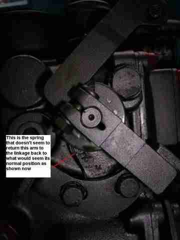

However, when inspecting the FI pump today, I noticed that the arm that connects to the linkage and which has a spring between the pump body and said arm does not spring back into position when I push the arm forward. See attached photo of the part I am talking about. Instead of springing forward and resting on the stop, the arm sticks half way. I can push it forward by hand quite easily, but it is definately sticking.

I can see that the spring is small, and would guess that the other sprung part of the linkage on the other side of the rocker cover would be sufficient to drive it back to its normal position, but I'd like to know whether any of the FI pump ninjas think that this could be a problem.
Also, I am not even sure that the spring has been relocated correctly. From the position in the photo it looks a little random just stick where it is. Can I ask if someone else with a 230SL can see if their pump looks like this?
Apologies for the crappy photos. The first one has a thin red line pointing to the spring in question.

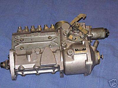

I noticed that the arm that connects to the linkage and which has a spring between the pump body and said arm does not spring back into position when I push the arm forward.../.. Can I ask if someone else with a 230SL can see if their pump looks like this?
I enclose a pic of a 230SL 6-plunger pump. As you can see, the spring is an open one. Never seen a spring with cover like what´s shown on your photo

Mine also sticks halfway closed when the linkage is disconnected but, as you say, once the linkage is connected it does return to its stop. I guess yours will do the same.

Hopefully he didn't remove the injection pump lever from its axle to do the "repair". Probably not, though. It is not uncommon for the pump arm not to return completely to the idle speed stop (also should not be changed), as there is friction inside the pump between the cam follower and the governor. Usually its not at the halfway point, but I would not worry beofre you haven't tried the pump out.

The pump on my car started sticking a tiny bit a few months ago (not always returning all the way to stop, which causes a bit higher idle rpm's). I replaced the various springs on the linkages, and lubricated the one on the pump, and now it seems ok again. I also checked 12 or so of the FI pumps I have laying around, and as Tom mentions, most faithfully return to stop everytime, but some don't.
