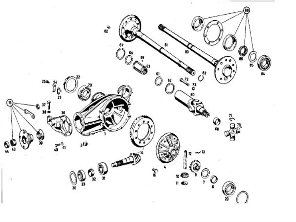

Re: MB Specs for differential bearings
« Reply #2 on: July 27, 2007, 17:34:53 »
Download Attachment: axle parts lista.jpg
40.48 KB
