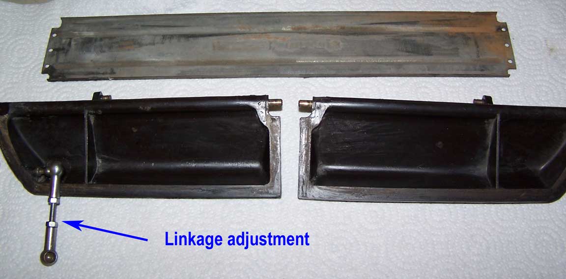

Here is a picture of the adjustable control arm that Jeff is referring to.  A picture always helps...
Download Attachment: flapadjustment.jpg
55.67 KB

That is exactly what I mean. The middlepiece is indeed adjustable and to my insight you first screw it as far as possible into the upper part and then unscrew it so it enters into the lower part. But then it's too long and obstructs the lid to close entirely. I now found that the ball cup for operating the heat exchanger is removable on the plastic lid (MB 230 1963-1968 owners workshop manual p.155)
