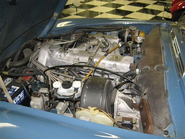

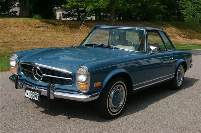

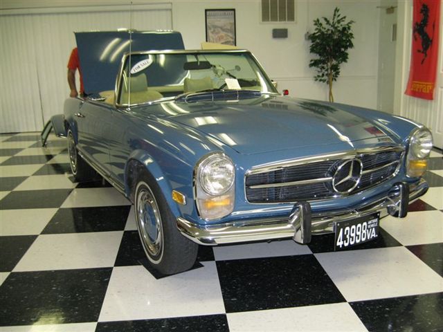

Here are some photos of a 1969 280SL that my father in law is considering for purchase.  I've inspected the car based on advice I've seen here and elsewhere, and now that I've gathered the information, I'd really like to get some opinions from the forum before we proceed.
Presumably a California car for most of its life, there is very little rust, or evidence of previous rust repair.  The fenders are original, with the weld dots intact near the hood opening, and no rust under the lip, or anywhere else.  The character lines coming off the headlight trim are intact.  Floors look fine, with original undercoat still present.  A little bit of rust on driver's side inner fender (painted body color), presumably from a leaking brake fluid reservior as the one on it now is new.  Straight car as far as I could see, and using a weak magnet I found no signs of filler on the steel panels.  Only rust I found was a bit of bloom under the trunk mat.  All stainless, trim, signals and bumpers in excellent shape.
Engine started readily from cold, and revved well to 4500 rpm (most I took it).  Shifted well.  Tires are suspect - one is a Firestone-Phoenix that must be the original spare!  This caused some excitment when testing the brakes as different tires gripped differently..
Most brake hoses are original, and one is leaking.  Some wheel bearing play in driver's front wheel.  Minor leakage from the transmission and engine.  Transmission fluid nice and red, oil at correct level and fairly clean.
25 lbs oil pressure at warm idle in Drive, no smoke, good temperature.
Interior is good - wood is fine, dash is showing some minor cracks around the instruments.  Original Kangol seat belts probably should have the webbing replaced.  Minor cracks near spokes of steering wheel.  Carpet (blue) is sun faded to green in some areas.  New softtop in incorrect material (vinyl) fits well.  Hardtop very nice.  Seat material under sheepskin shows some flattening (pads) and holes, but are comfortable.
Heater control levers do not seem to work.  There is a jerry-rigged (how appropriate for a German car [:p]) valve under the hood to control water flow to the heater.  Speedometer needle jumps around when driving - new cable needed?

It looks like it's for sale at a dealership, so that might jack up the price some.  To negotiate, maybe we can estimate the cost of putting some of the things "right".  Use that info to help get the selling cost down.  OK team, help me evaluate some costs:
- new tires: $300 - $600
- repair trunk rust: ???
- repair inner fender (if needed): ???
- correct over heating issue:  ???  New thermostat?  New water pump?  New fan clutch?  New/repaired radiator?  Proper tune up?  Big variables here, but nothing unique to the 280SL.  Others here have gone through this and can comment on costs.
- correct soft top:  $400 - $600 plus installation
- heater & vent controls:  ???  Other have fixed this, I don't know the cost of parts but the labor can take many hours.  An, once you're in there, then you start looking at fixing other things.
- speedometer bouncing:  $100 or so at Palo Alto or other instrument repair specialist.  Plus cost of new cable.
Eveyone else can pitch in with their experiences on fixing these problems and help Robert get the car for the appropriate price.

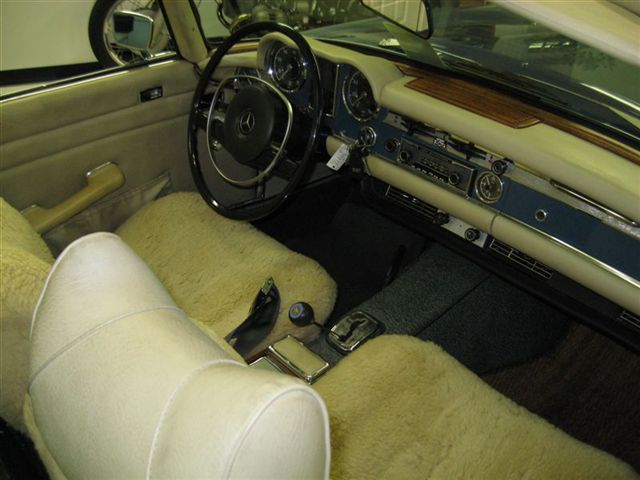

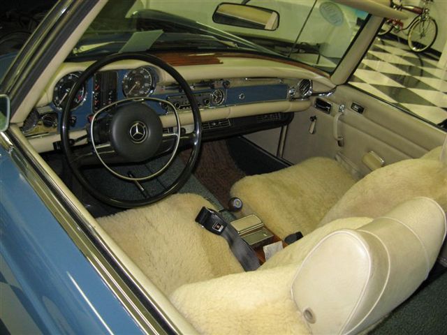

2. Have those door panels been re-covered? Looks like it may not be the original Tex. (Not a big deal. Just a minor observation.)

Congrats. On closer inspection, you can see parts of the interior were re-done. The door panels and at least part of the dash, I believe. (Looks like the screw is missing above the stereo.) I'll bet those were done when they put that soft top on. Perhaps the same shop did it.
In any event, I think it was a very good buy. It will be easy to take that car to the next level.

That knob on the transmission shifter, is it original?? correct for that year?? I have seen it on a few other 113s. Mine has the smaller black knob (auto transmission).
