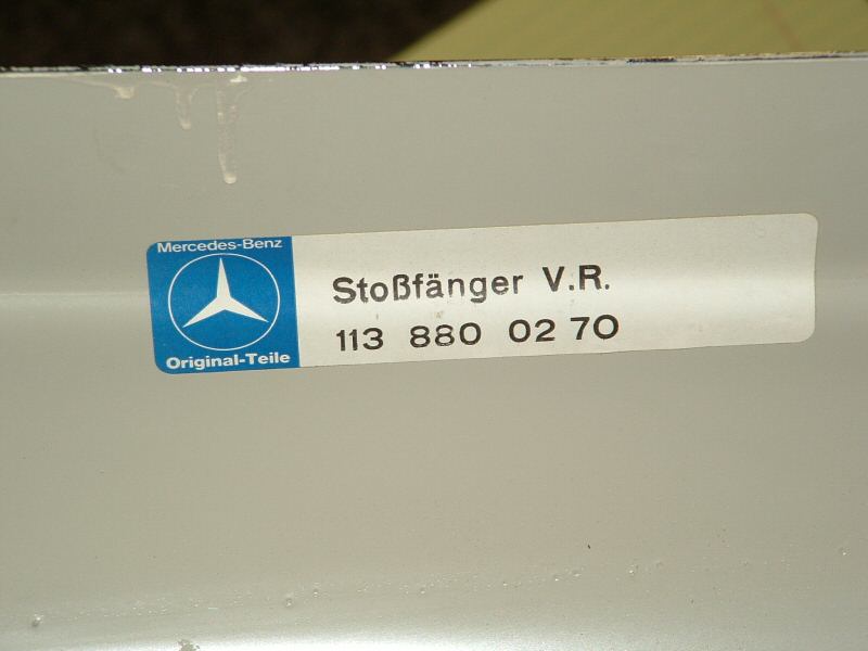

Here's a picture that I saved and used to match the color when I sprayed the inside of my bumbers after I had them rechromed.
Download Attachment: bumper_color_158_grey.jpg
36.03 KB

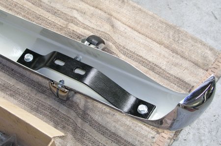

Here's another picture showing the color (note: not my pic or bumper).
Download Attachment: bumper.jpg
37.27 KB
