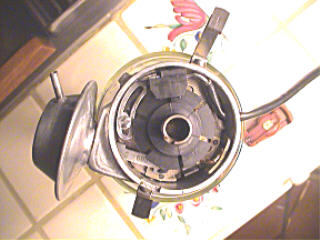

You're welcome.  I have the Crane XR-700 in my 1970 280SL.  It works fine.  You can run a search on it and get comments from others.  It completely replaces the MB box located under the battery.  In fact I put the Crane box, which is smaller, in the same location.  There are some tricky parts to the install.  If you need help let us know.  Here is a pic of the optical trigger.

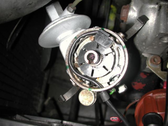

« Reply #7 on: June 15, 2007, 10:24:31 »
Here's a Crane installation with the pivot pin in place:
Just use the smaller of the two six slotted wheels.
Thanks to Peter van ES for today's picture loading lesson [:p]

Hey Naj. How come your vacuum device is on the radiator side of the diz. Should mine be?

Naj - do you still have that condensor that's stuck to the side of the distributor body hooked up? I am pretty sure that I was able to take it off when I installed the electronic ignition on my car.
Oh, and on my car also the vacuum unit is in the same spot as Naj's.

« Reply #10 on: June 16, 2007, 01:44:27 »
Hello James,
No, James, this is the 051 Vacuum retard on a 280 SL. Yours should be pointing to the firewall  :)
Hello, Cees,
I've left if there in 'case' I have to put the points back on the roadside. No, its not hooked up. The points and other bits are under the suspension cover!
The theory is: If you're prepared for it, it might never happen  :?:

« Reply #11 on: June 16, 2007, 14:24:56 »
Thanks Naj. I noticed the illustrations in my workshop manual have them in same place as mine...
