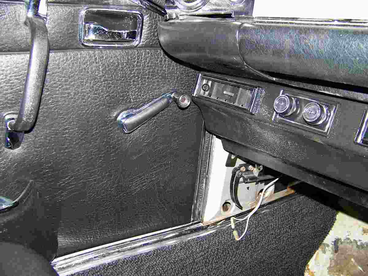

I would interested in knowing if your fingers get cought on the underdash unit when you turn the window crank.
I saw two of the BUD's A/C units that would scape your fingures every time.

You are right about the window winder; it will scrape your fingers if you are not careful. I must thank you for your comment though as it did make me check the winder did not touch the A/C unit before mounting as it could easily do so and make opening the window only possible with the door open.

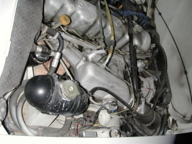

Originally posted by DavidBrough
 I am now down to the last bit, mounting the dryer and am looking at placing it on the right drivers side of the fire wall between the hood/bonnet catch and the heater outlet pipe. I would be keen to know where others have mounted it and if this is felt to be the best place.
David Brough
1969 280SL Auto (now quite close to having A/C)
This any help??

Thanks for the photo Naj. With the hose lengths I had the dryer ended up by the gearbox filler neck.
