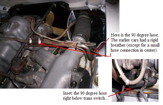

I'm unsure about the hose you folks are referring to.
On top of the valve cover, there is a short 90deg elbow hose (1) made of rubber. This hose is connected to a plastic pipe (2) that runs over to the intake and then bends by 90deg toward the front. This plastic pipe is connected to the intake via a little stub hose (3) made of rubber.
Are you referring to (1) the elbow hose, (2) the plastic pipe, or (3) the stub hose?  Which of the three does the part number below correspond to?
This evening, I replaced my elbow hose (the previous owner had installed a bent piece of heater hose), and found some cracks in the plastic pipe. I believe the stub hose was specially formed and is NLA (unless someone knows otherwise). I simply used a short piece of 0.5" heater hose (which I plan to soon replace with fuel-rated hose)
So, anyone have a part number for the plastic pipe? (and the stub hose, if still available)

« Reply #7 on: May 18, 2007, 18:24:56 »
Hi Waqas. I think I can clarify. The earlier cars had a different breather hose than later cars. It was mostly metal (and prone to rust I'm afraid)... Moreover, many cars have "converted" to the later ones because they are only ones available.
Download Attachment: breather.jpg

Hello James,
Thanks for the reply and photo-- it all makes sense now.
