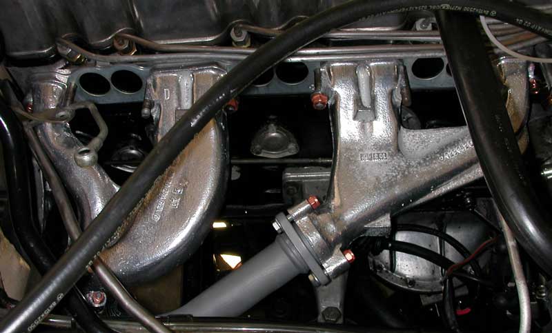

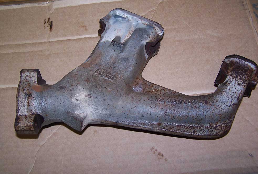

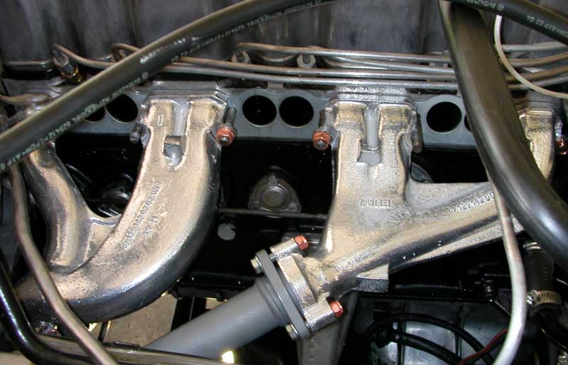

3. Removed exhaust manifolds and had them ceramic coated.  May not be "OE correct", but they do look nice now.  See before and after pics, attached.

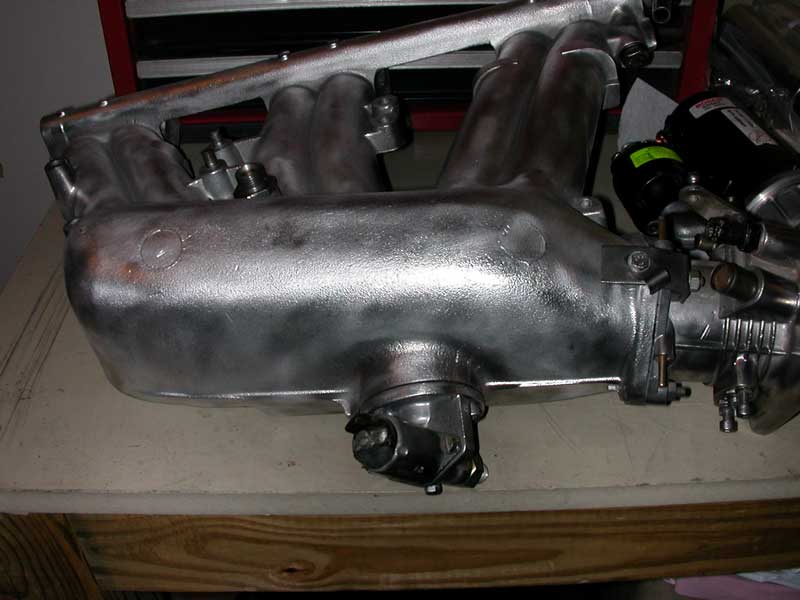

4. Removed and cleaned, buffed, intake manifold (see attached pic).  I did not take a "before" pic, but it was filthy!  Lots of carbon build-up inside the intake.  Took lots of cleaner and elbow grease to remove the crud!

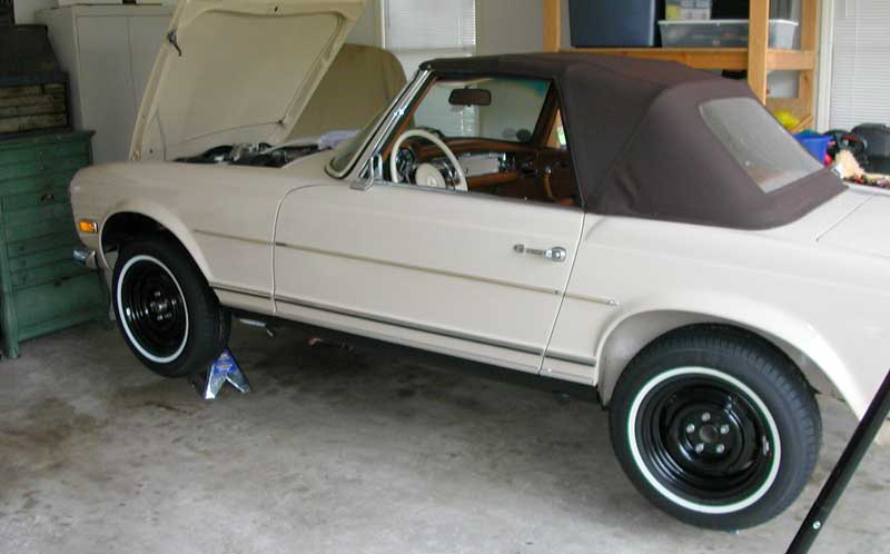

6. While car was out of service for soooo long, I also had my wheels sandblasted & powder coated...  much nicer now, even though you can't see them with the hubs on...
