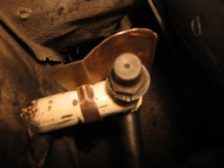

I will take a picture next time I see my car (a single car garage in the center of Amsterdam, where I live, costs around $100,000, so I have one that is located 15 minutes away from my home - by bicycle).

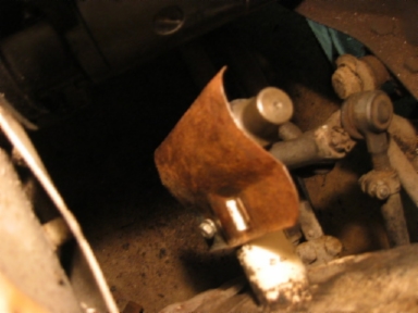

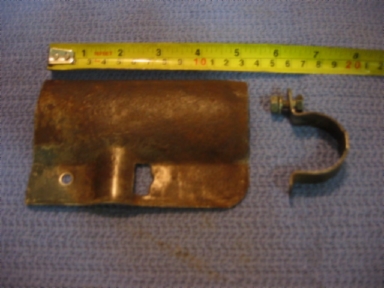

Pictures of Idler Arm Heat Shield:
Download Attachment: Heat shield 2.JPG
77.08 KB
Download Attachment: Heat shield size.JPG
75.64 KB
Download Attachment: Heat shield.JPG
69.5 KB
Will W14

« Reply #10 on: May 26, 2003, 20:30:19 »
My car does not have that heat shield.  Does anyone have a part number for this part?
Thanks in advance,
  • Posts: 7508
Re: hanging a new exhaust system
« Reply #11 on: May 26, 2003, 21:51:35 »
Hello Tom,
From Edition C (dealer's parts book) table 17, Goup46, page 125, parts 135 and 136
Two parts and three pieces of hardware are needed. protective plate #108-463-00-90, bracket #111-463-11-40, Screw #000933-006026, lock washer #000127-006203, nut #000934-006006.
