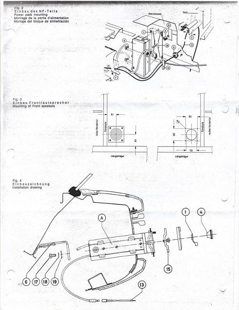

Hello Steve,
Yes, it mounts on the firewall behind the glovebox using a special bracket.
Here is some factory literature showing one installation method.
Download Attachment: radio.JPG
75.98 KB

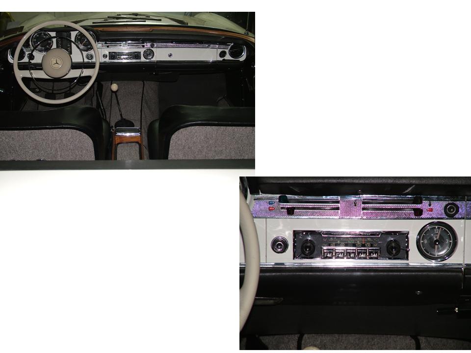

Again, many thanks to all.  The radio and amp are installed and playing nicely through a new Becker speaker (the radio has an MP3 adapter so the maiden voyage consisted of hits from 1964 courtesy of Napster.)  Here's the final product...
Download Attachment: 64Becker.jpg
62.88 KB
(the reflection looks pink but I assure you the chrome is unmolested!)

Wow. Looks great Steve. Great interior. Hope to see it upclose one of these days!
