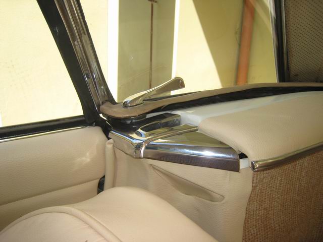

Is this the way the latch should look like?
Download Attachment: Resize of IMG_0857.jpg
46.06 KB
I find it to be sitting rather high...

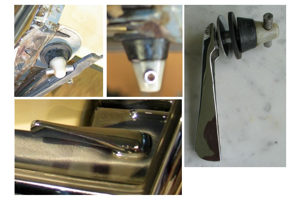

Hello Muf,
here are a few pictures of the handle in various stages of original assembly and dismantling. Perhaps that may help you. I assembled it as follows from top to bottom: handle, - through hole in MB-tex and hardtop body  - chrome ring, rubber O-ring, black plastic cone, white plastic cone with locking bar.

Alfred, thank you for the excellent photo! That is what I thought. This way I installed it. But it is still sitting too high. Maybe my Hardtop base is already bent...

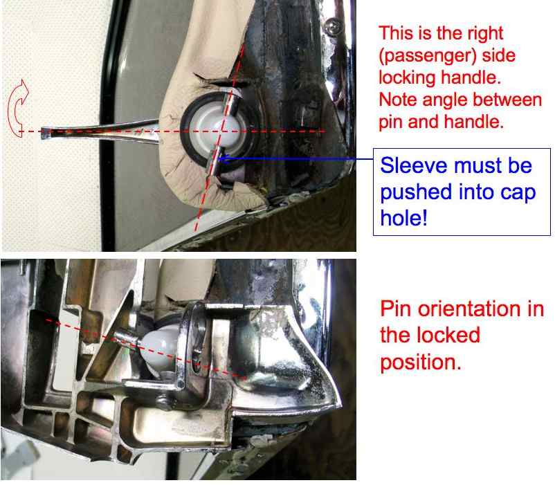

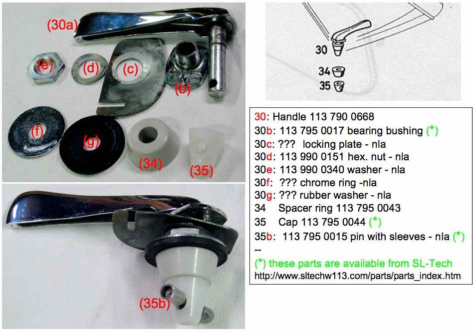

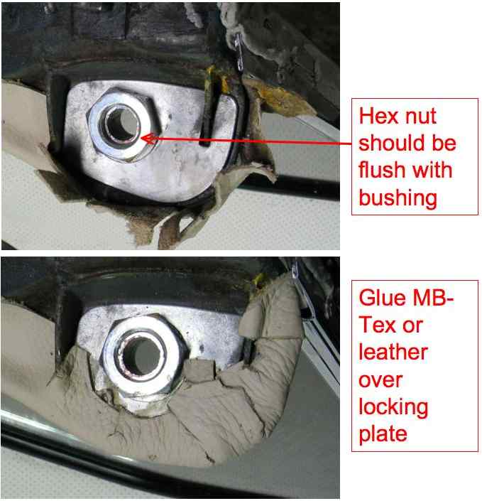

Today I ordered a new pin and sleeves for the hardtop handle from Gernold and during the conversation he warned me that the left and right handles are not identical. Sure enough when I checked I had them reversed.[:0]
So I am posting a few more pictures showing how to assemble the handles and how to distinguish the left from the right handle (see picture #3).
Download Attachment: HardtopHandle.jpg
61.46 KB
