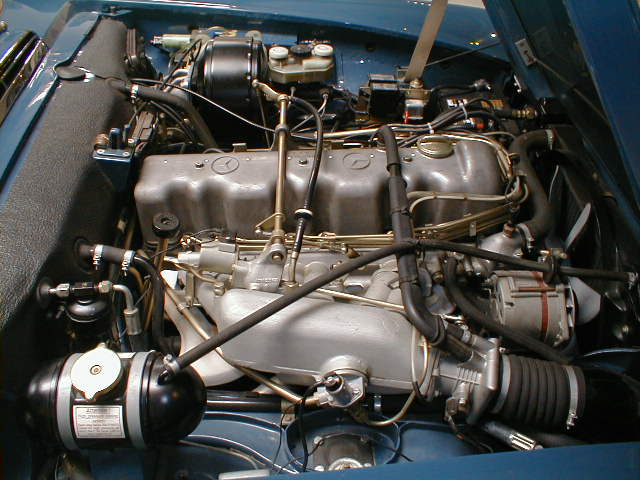

Are you going for factory-like originality or what you personally like?  Many of the metal tubes (fuel lines, linkages, etc.) were originally a goldish finish.  Here's a restored car:
Download Attachment: 280SL Engine.jpg
62.04 KB
