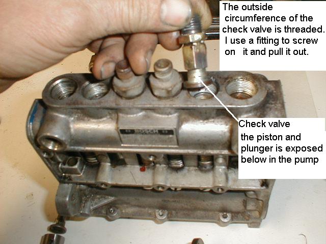

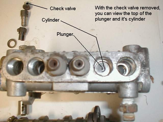

If one piston is stuck the entire rack will bind.  Your numper one piston (plunger) in the injection pump is stuck. Remove the injection line remove the 19mm fitting on the pump which is over the stuck plunger. Below it you will find a check valve. The outer circumference is threaded so you can screw a fitting on it and pull it straight out. Below it you will be able to view the plunger and the cylinder. Soak the assembly with your favorite penetrant. Rotate the engine and verify that the plunger does not return. You can take a wooden golf tee and tap the plunger downward to make it return. Exercise the rack and the plunger by turning the engine and tapping the plunger down. You should be able to free things up.  When the plunger is free, the rack will also free at the same time. Not a big deal, I have unstuck many of these.
It is critical to re-torque the 19mm fitting to 18 ft. lbs. during re-assembly. I will post some photos shortly. Keep us up to date.
Download Attachment: pump1.JPG
