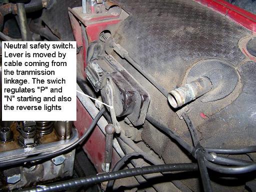

The nuetral safety switch is easy to reach on the firewall. You will see a cable going to it. Check to see if the lever arm moves when the shifter is moved.  If not disconnect the cable and move the lever manually to a position where the car will start.  Use caution, the stater will engage in a drive gear until the problem is fixed.
Download Attachment: ns switch1.JPG
68.6 KB
« Last Edit: April 08, 2007, 16:44:47 by ja17 »

« Reply #9 on: April 08, 2007, 18:42:02 »
Joe, that's IT!
The wire itself broke, so I toggle it and it started!

« Reply #10 on: April 08, 2007, 18:54:13 »
Be careful Chris, the car will now start in drive or reverse a dangerous situation until the cable is replaced.
