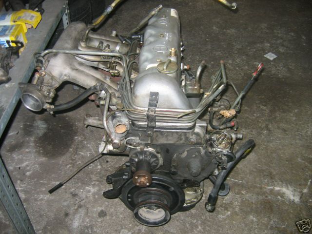

Its certainly possible to remove the water pump without removing the harmonic balancer. The big decision will be to remove the radiator or not?
Download Attachment: Eng3.jpg

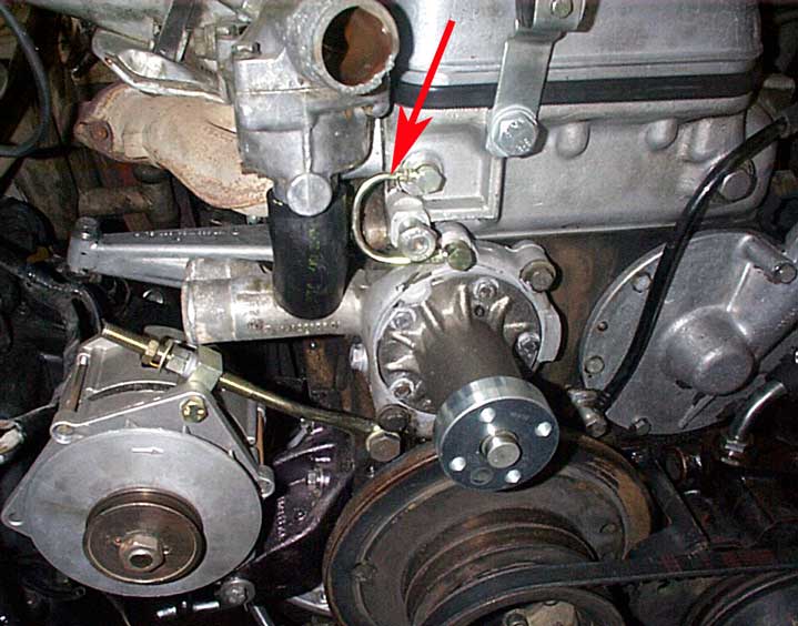

Another item to replace while you're doing the water pump is the small water passage metal pipe.  See attached pic.
Download Attachment: waterpumpnew.jpg
63.49 KB
Not sure if all model years has this piece, but if yours does, I would replace while all the other pieces are out.  Make sure to also buy the small washers that go on each end.  I used Permatex sealant for water pump bolts and the paper gasket.  Also used a small bit of Permatex on the passage pipe bolts.
Good Luck!

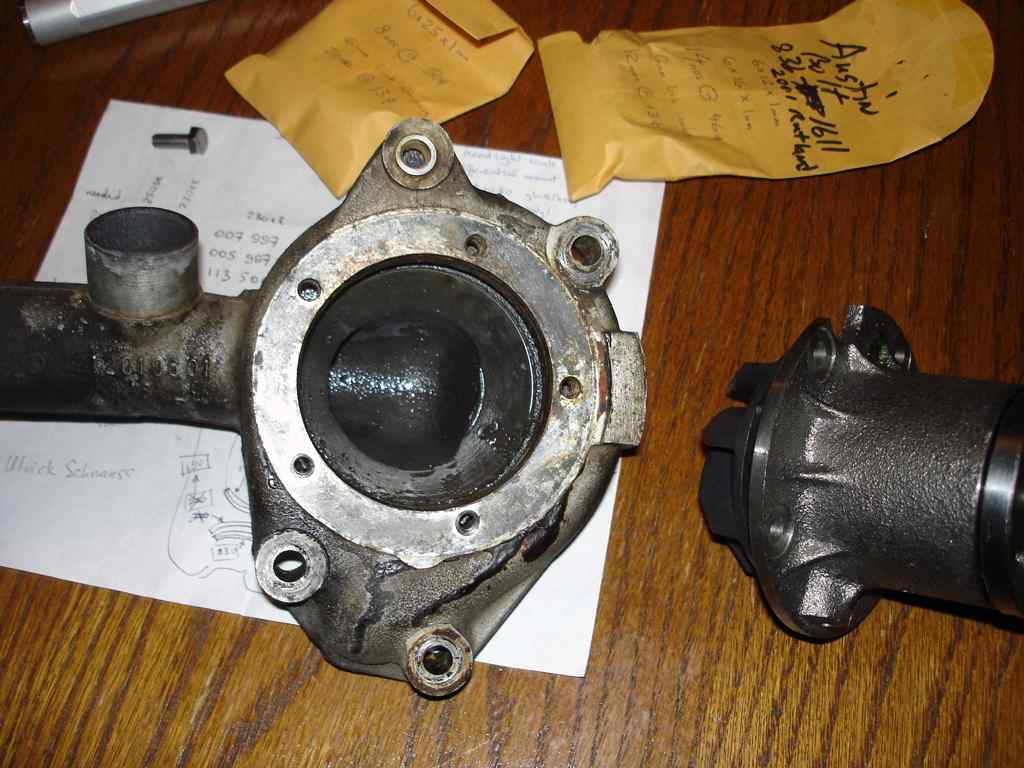

By the way- does anyone know what the small cut-out (like a small bite) from the water pump flange is for? The images from Bob and Naj below apparently show the water pumps mounted with different orientations of this flange cut-out. Does it need to be oriented in any particular way?
WAQAS in Austin, Texas
63.49 KB
Good Luck!
I always thought this small passage metal pipe was an oil passage for the chain tensioner. Are you saying it carries coolant? Either way, can it simply be cleaned out? (soaked in degreaser, for example)
On removal, mine was missing the washers (but I've a whole new stack of them). My question: is there supposed to be one or two on each hollow bolt? I always assumed a pair of washers "sandwiched" each pipe end (total of four washers)... is this true?
Thanks again for all the help!

Hello Waqas,
Yes the tube is for coolant and it has a total of four aluminum seals.

Thanks for clarifying the purpose of the bypass-line! I guess it makes sense, it IS connected to the water pump housing...  :?  :D
The washers I was sent are copper, not aluminium (8x12x1mm). Are they equivalent for this purpose?

Hello Waqas,
Copper is fine. Be carefull not to overtighten those hollow bolts they will break off. You can use a little grease or antiseeze on the seals and bolts so that the parts torque and seal easily without binding.

I see you say that the tube is for coolant but why is that small tube there?

Hello Bob,
It is designed to help bleed the air out of the cooling system during a re-fill or change. This allows coolant to flood the water pump housing without an air block.

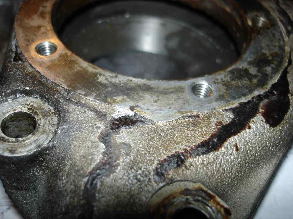

So I finally got around to heli-coiling the two water-pump housing bolt holes:
http://www.sl113.org/forums/uploaded/Waqas/200742031949_waterpump-and-housing-small.jpg
Zoomed-in on the two bolt-holes:
http://www.sl113.org/forums/uploaded/Waqas/200742032123_waterpump-housing-helicoiled-small.jpg

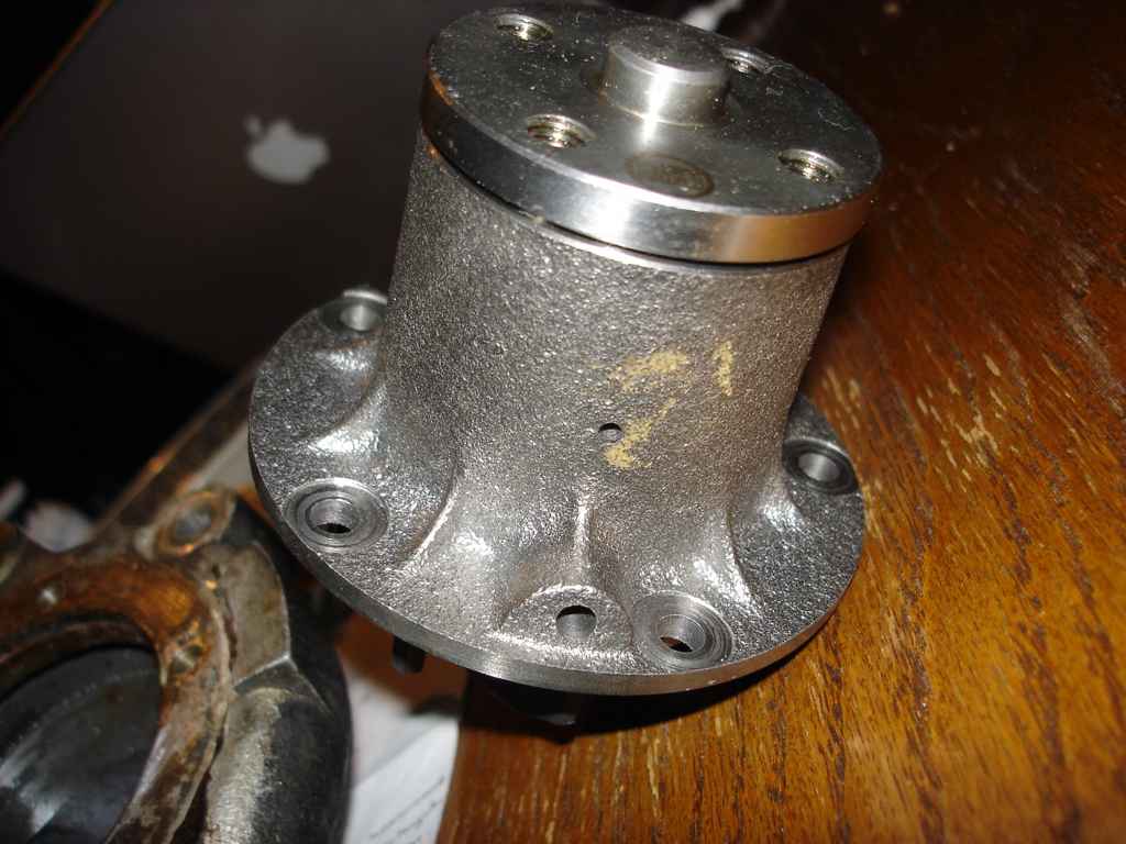

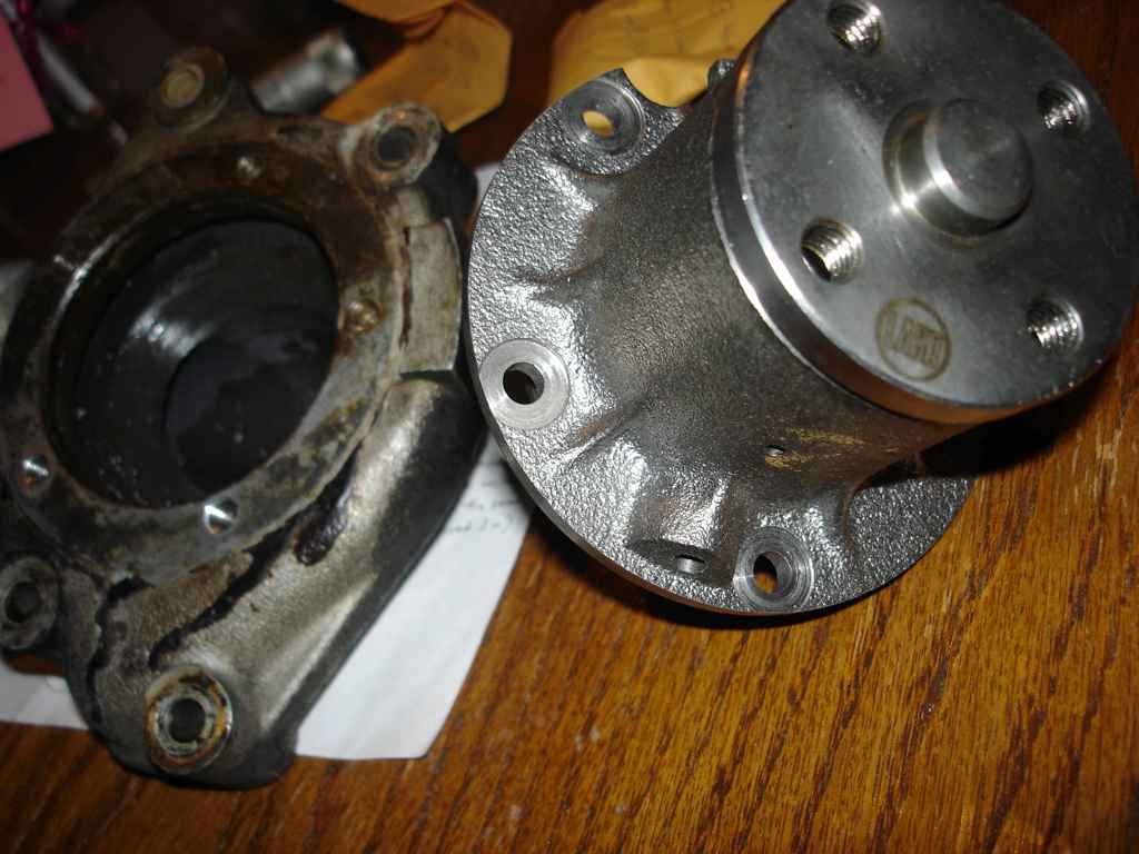

My question is about the water pump: is there any particular orientation necessary? Do the weep-holes need to facing any particular direction? (up, down, sideways, etc)
Here's the new water pump:
http://www.sl113.org/forums/uploaded/Waqas/20074203253_waterpump-1-small.jpg
Here's what I assume are the 'weep-holes':
http://www.sl113.org/forums/uploaded/Waqas/200742032613_waterpump-2-small.jpg
Thanks in advance for any help!

Matt,
Yes, it's a new water pump. My car uses the 'short-hub' pump, and it has a hub-extender... not quite sure why. I never went back to figure out whether the short-hub pump together with extender could be replaced with a long-hub pump. Since both short and long hub versions are readily available, I figured "if it ain't broke..."
