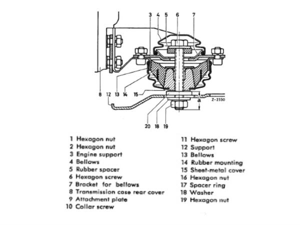

so, I have the tranny on my 66 230 in place waiting for the rear mount and the large plate.  2 questions.
1.the rear mount had 2 spacers that I believe go on the lower studs between the nut and the mount.  is this correct?
2. the rubber washer that goes between the spacer above the mount plate and the rear mount is squished.  any idea how thick of a rubber washer I need to replace it?

Hope this is the right mount detail.
