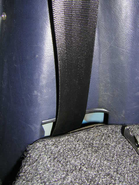

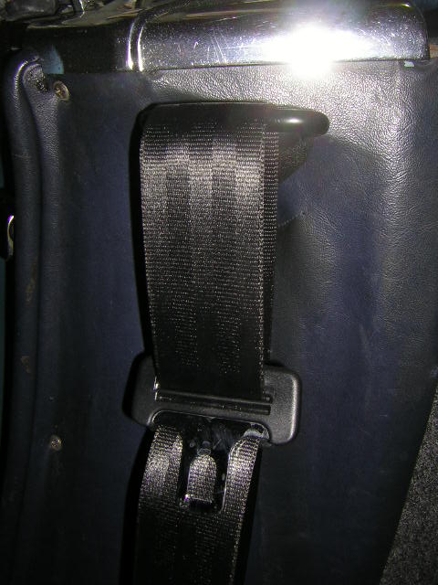

Photo 1 shows the shoulder anchor point. If you’ve read my addition to that [now THIS] thread on the site, you’ll see that I have used the pre-drilled hole provided at the top of the B pillar rather than cut into the hood top and put the shoulder mount the other way up. (Re my comments about cutting into the panels – the fewer cuts the better). It was then simply a case of making a small cut into the vinyl and putting the bolt thru. I didn’t use the both that allows completely free rotation (it has a collar where the thread stops – you’ll see when your kit arrives) as it would have screwed up the belt a little as the bracket is top heavy. Instead, I used locktite to secure a normal bolt which allowed my to use a spring washer to impart a degree more friction on the shoulder piece, without denying it all movement (which would make putting it on a pain the posterior)
Photo 2 is of the B pillar with the cut away we’ve already discussed. Learn from my error: cut away a little at a time. I cut away about 8- 10mm too much. You can see that I’ve taken the photo with the wooden shelves in position to give you an idea of how tidy it looks. Not also that I’ve put a small piece of hose where the belt rubs against the vinyl to better protect both.
