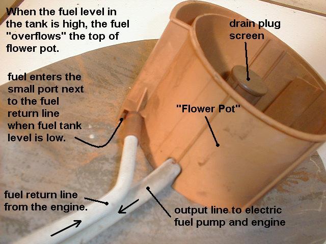

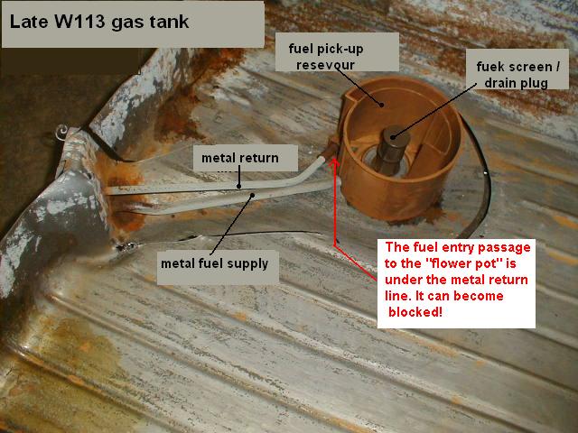

I would also check that the fuel return line is not clogged up, especially the bit in the tank. The lines rust from the inside and the debris ends up in the tank.
http://www.sl113.org/forums/uploaded/ja17/200611475414_fuel%20tank%20with%20fp%20ill..JPG

Assuming fuel delivery pressure and quantity is correct try the folling procedure;
Remove the fuel tank drain strainer first make sure it is clear. Remove the fuel line between the elec. fuel pump and tank, run a steel cable, long brush or such down the fuel outlet tube of the tank to the drain opening at the bottom of the tank. Also snake the fuel return line. It must be clear into the "flower pot".  You may want to remove the fuel gauge sender so you can watch what is going on in the tank.  Also remove the fuel line intake fitting going into the electric fuel pump it has a screen it it which is easily clogged. Finish by blowing compressed air throught the fuel tank tubes.
Clearing the fuel intake opening in "the flower pot"  requires a little more work. The opening is directly below fuel return line going into the "floweer pot" This is deep within the fuel tank. It can be cleared with a long compressed air nozzle or wire from the fuel gauge sender opening. However you will need to know exactly where to find the opening. view the information on the "fuel tank tour" first.  I will post a picture of it if you cannot find one on "the fuel tank tour".
The fuel tank vent must also be functional. Test for a problem here simply by loosening the gas cap the next time your car shuts down. It should re-start after loosening the cap.

As Dan has mentioned in past posts, make sure the return line going from the engine compartment back to the fuel tank is clear.  Remove the gas cap and blow some compressed air from the engine compartment back into the fuel tank, make sure the gas cap is off!
Now onto the flower pot.  Assuming, fuel pressure and delivery is correct, all fuel lines are clear, fuel tank screen is clear, electric fuel pump screen is clear, main filter is clear, and the fuel tank vent is clear you can check the "fuel fill port" in the flower pot. this is independant of the fuel return line. Look closely at the photo. the port is along side and beneath the fuel return line.  It does not take much dirt to plug it up since it is in the lowest part of the entire fuel tank. You cannot get to it unless you remove the fuel sending unit and go in from above. Use a long compressed air nozzle to blow it clear or a wire to clear the port. Caution, fuel vapors are dangerous, use a safe trouble light or flashlight. Sparks from lights and static electric must be avoided. It's best to do this work outdoors with plenty of ventilation, good sealed containers to hold fuel, with fire extinguisher and garden hose near by.
Look at the photo of "flower pot" closely to find the port and learn how the fuel deliver and return lines work.
Download Attachment: fp.JPG
63.12 KB
« Last Edit: April 04, 2007, 18:24:12 by ja17 »
