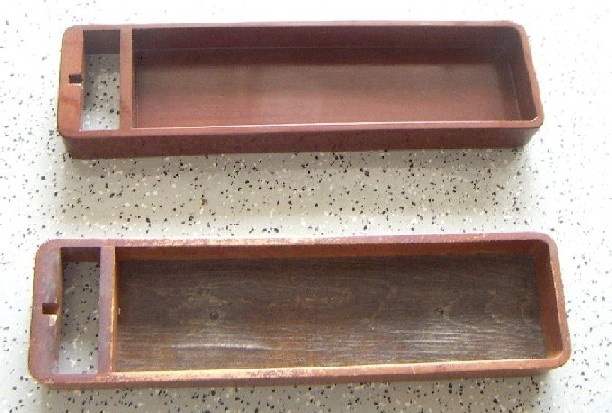

If you cannot find a good used set, find a MB dealer who will give you a good discount (try Caliber Motors) and price new wood there. I had a friend who bought all new wood from the dealer last summer. With his discount it was less than many places charge to repair and refinish old wood.
Here is some additional information;
Download Attachment: wood ill.JPG
44.04 KB
Download Attachment: wood ill2.JPG
42.77 KB
