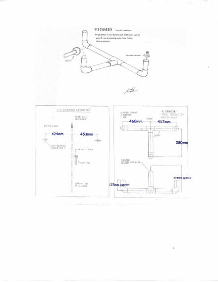

I just replaced all of the rubber bushings and mounts in the rear axle and the shop manual says the rear axle centering needs to be 36mm +/- 2mm from the centerline of the car.  It calls for a special tool.  I have yet to find a shop that knows how to check this.  After searching this forum i found a picture of a homemade tool to check the centering of the rear axle.  I understand how the tool works, but I am not able to read the dimensions off of the picture to make the tool.  Can anybody here help me with this?

This should help.
Download Attachment: 113tool.jpg

so, I reviewed the photo to make the centering tool attached below and the one on the home page.
I am confused, both have different dimensions in each photo set.
for example the photo below has
424 and 453 to center line?
then the next slide has
460 and 417 for the centering tool?
just trying to verify before I make the tool
thanks

The centre of the chassis is located 424mm from the left trailing arm mount, and 453mm from the right one (424+453=877mm). However, the tool should be used to align the rear axle carrier (which is not at the chassis centre line). Hence the tool is designed to align a point 417mm from the right trailing arm mount, and 460mm from the left one (417+460=877mm).
When I replaced the lateral bushings on the rear axle (along with everything else vaguely rubberish!), I used Arthur Dalton's wonderful diagrams to take the measurements. I didn't make the tool (probably should), but used plumb lines to project onto the garage floor.

Forgot to make this absolutely clear:
Since the chassis centre line lies 453mm from the right trailing mount, and the differential carrier centre is positioned 417mm (+/- 2mm) from the same point, the carrier will end up exactly 453-417=36mm (+/- 2mm) from the chassis centre line!

so, made the centering tool this weekend.  It worked out ok.
the only big difference is the drivers side of the centering tool was 453 - 454 in length not 460 mm.
I maintained the 417 mm on the passenger side length
After I cleaned the gunk off the diff pivot bolt I noticed there was a dot or small drilled out pit in the center.
when using the tool the pointer was to the right of the dot but close to the center.  probably +/- 2 mm from the center of the dot.
I have a friend that has a machine shop, I am going to have him verify the dimensions of the tool and double check the axle again.
