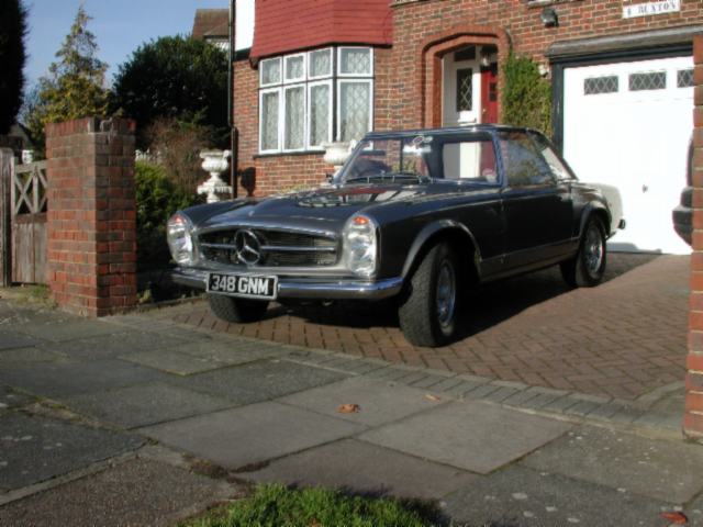

Here is my 230SL with 195/75x14 white strip tyres, which I think looks very well.............

Nick, here is mine with 205 Fuldas, Rob
