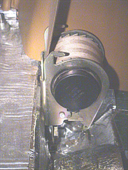

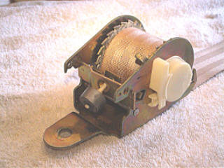

Jim, how did you fasten the retaractable part under the parcel shelves?  Looks to me like you could bolt these to the frame but I am not clear how you would be able to reach inside the frame to put on the retaining nut.  I have researched all of the pictures on our archives and have seen many with the retractable part fastened beneath the parcel shelves but it is unclear to me how they are fastened.
Mike
Re: Seat Belts
« Reply #4 on: March 21, 2007, 17:23:58 »
Mike,
I drilled a 1/2 inch hole in the cross member under the parcel shelf.  A welder comes in handy.  I welded a large nut to the cross member over the hole.  I was then able to put a bolt through the retractable seatbelt reel into the nut and tighten it.  The excess threads went behind the nut into a hollow space in the cross member.  Here are some pics to give you some idea of how I did it.
Download Attachment: seatbelt8a.jpg

« Reply #5 on: March 21, 2007, 17:26:28 »
Here is another pic.
