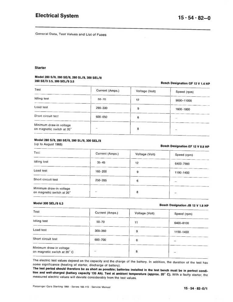

Hi Bob,
You may already have these specs, but if not....  see attached.
I'll let another expert jump in here, but for what it's worth, I tested my voltage yesterday and at idle it was reading ~13.5.
I am running with a 35amp alternator, which is only ~2 years old.  I replaced my old one which was a 35amp unit not knowing that in my later model, I should have been running a 55amp unit.
Good Luck!
