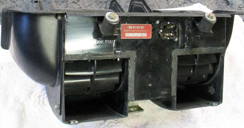

Time has come to put the heater core and fan assembly back in - last chance to lubricate the motor.
 :?:  Is it possible and easy to lubricate the fan motor without taking it out of the housing? :?:
I read somewhere that the cage fan blades break easily and are hard to remove.
Download Attachment: BlowerMotorHousing.jpg
33.83 KB

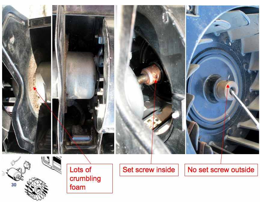

thanks for the helpful comments.  I took a closer look and cannot find a set screw on the outside of the fan wheels only on the inside (see pic). Is that correct?
I took the inner one off on one side and the wheel is stuck!  :(
I'll dripple some oil on the shaft where it enters the motor.  At this point I'll take a chance and put  the old motor back in, it ist still spinning freely.

I believe that there is a place on each end of the fan cage for a set screw so the fan cage will work on the right or left shaft. I just put lightwieght oil on the shafts and turned and wiggled the shaft side to side with the motor standing to allow gravity to help.

I believe that there is a place on each end of the fan cage for a set screw so the fan cage will work on the right or left shaft...
Thanks .. now I get it! *-:)
