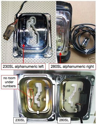

Scott,
what type of shifter console - 230SL type or 280SL type - do you have in your 250SL?  The older one has the gear numbers on the left and the number "0" for neutral,  the later has them on the right and a "N" for neutral. You cannot put a light bulb in the older style console.

Here is why:
In addition the numbers in the 230SL console are not open. So even if you put a tiny light (LED?) there you need to open up the numbers.
But you can always install the 280SL shifter console with the bulb in your car.

The light illuminates both. Because the plastic guide is transparent you can see the numbers and letters. Depending on how the light housing is turned usually number "4" right above the light is the brightest and the ones on the end are dimmer. The rim that outlines the shift pattern is also lit because the light is scattered through the plastic.
The available replacement guide fits both consoles but be careful with the tabs when you take the old one out. They can brake!  :(
