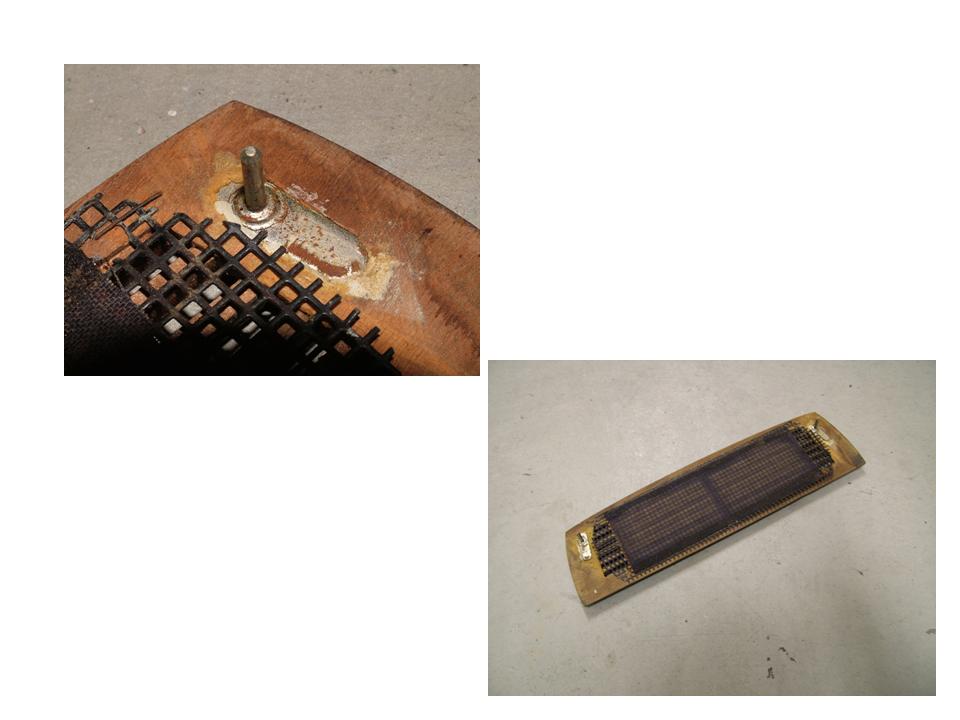

The grill probably has pins.  I've attached pictures of my grill (w/pins).  As you know my chassis rolled off the line a few months after yours so yours probably looks the same.  I was able to remove and reinstall the grill without removing or loosening the bows.  To do this I used a small standard screwdriver and gently wedged it under the grill and then pried up the grill (alternating between the sides so it came up evenly)  Believe me I was holding my breath during the entire process for fear of damaging the dash or the grill (or both!)
I hope this helps.
Steve

I removed my grill without a problem, once I loosened up the bows a bit. I now know how it works -- I have pins similar to Steve's -- although mine are not straight but bent slightly. Probably were straight at one point! With the grill off, I was able to screw everything back together (with help of a small mirror and a stubby screw driver).
