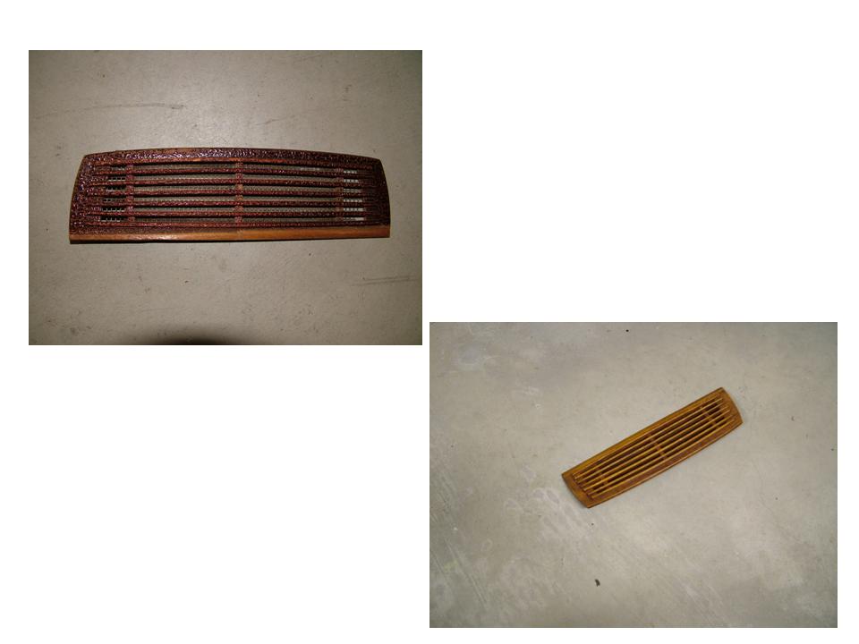

Hello All,
  I am a new member to this forum as well as a new owner of a 1966 230SL automatic. I was told that the car was in pretty good shape. It looked very nice and drove well. That was until I found out all the things that weren't correct. I didn't know this at the time. I have been slowly learning about the car. My question is, I had to change out the radio. I removed the speaker grille and found out it was held in with pins not screws. I was told the speaker grille was screwed in. Are there different types of speaker grilles or do I have one that is not correct?

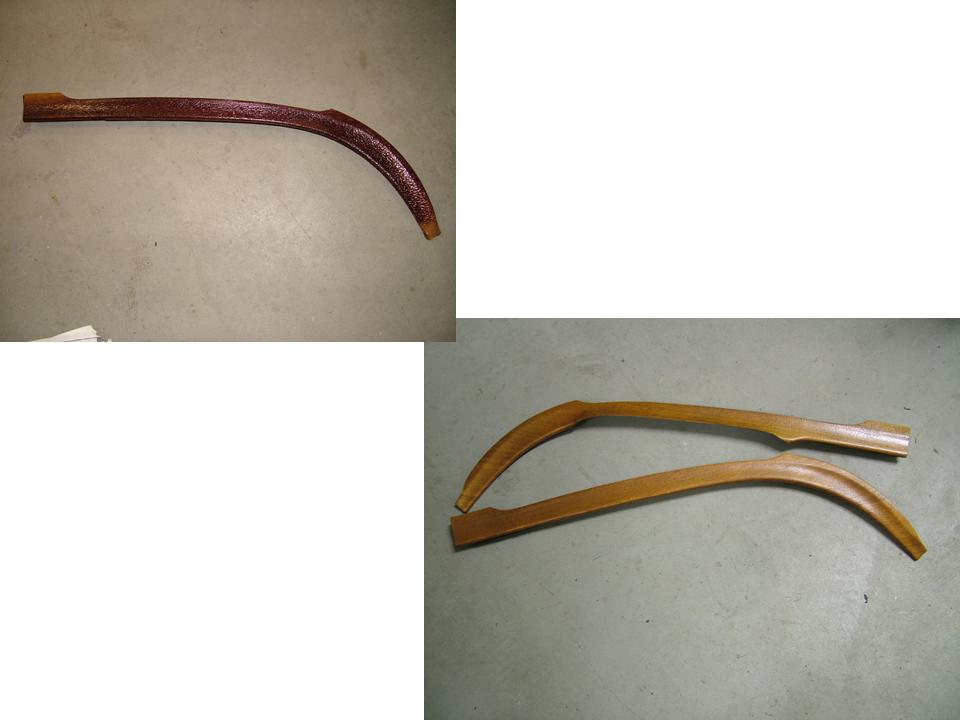

I'm not sure when Mercedes shifted to screws in the speaker grill but pins are correct for earlier 230s.  I encountered a similar situation with my '64.  The wood was in pretty bad shape when I bought my car (in Dec 06) and I couldn't find any screws, after careful examination of the situation I was able to pry up the grill and sure enough - two pins, no screws!  I have attached a picture of the underside of my grill with the pins (and a closeup of the pin.)
I've also attached a before-and-after shots of the grill and the bows to show you what's possible with a little care and patience.  My grill and dash wood were in pretty bad shape but with some Homer Formby's refinisher, some 0000 steel wool and a very VERY light touch I was able to refinish the pieces.  Be aware that these pieces have a very thin veneer that is easily rubbed through. Search this forum some very enlighenting experiences with the veneer and with getting the bows out (the passenger side is relatively easy, the drivers side is quite difficult.  The passenger side should have two nuts, the drivers side has three and the middle one is right about instrument cluster - it's best left to someone with very slender fingers.)
