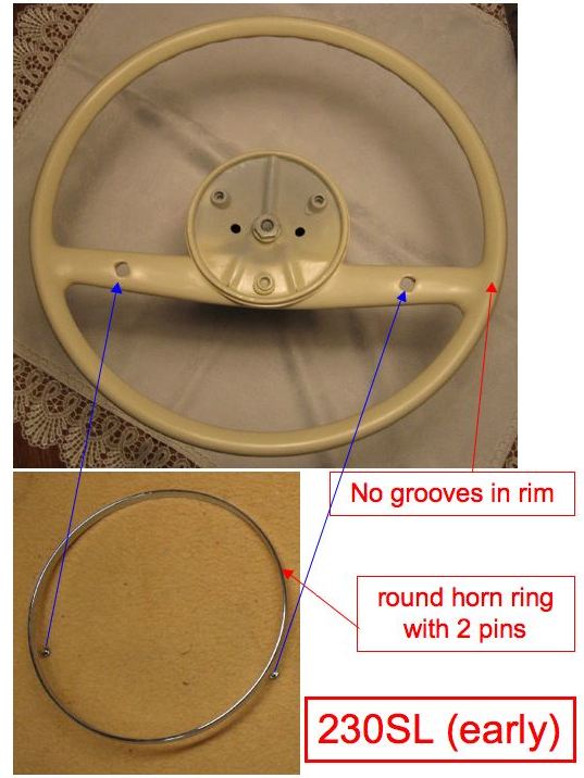

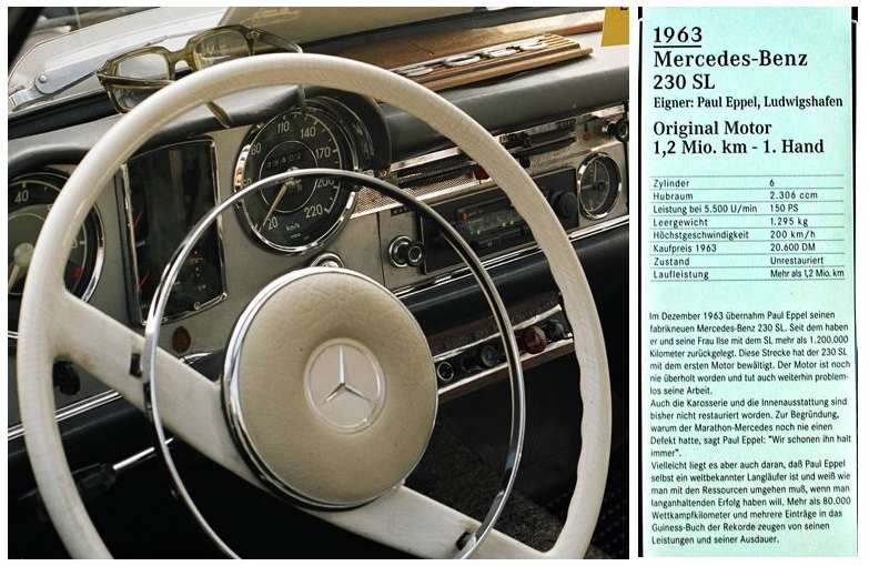

Type I – early 230SL (to about chassis #2038):
Color:  black and ivory (white).
Horn ring: round with 2 pins through the crossbar
Wheel: no grooves, no holes on the inner side of the rim
Center pad: outer ring (all chrome) and inner chrome ring around plastic center star.
{no picture, please add}
Center star is surrounded by another chrome-mirrored ring within the plastic.
Download Attachment: 230SLearly.jpg
57.8 KB

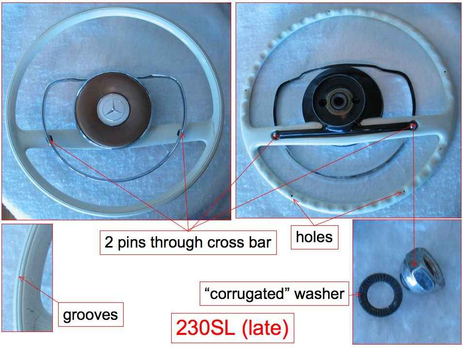

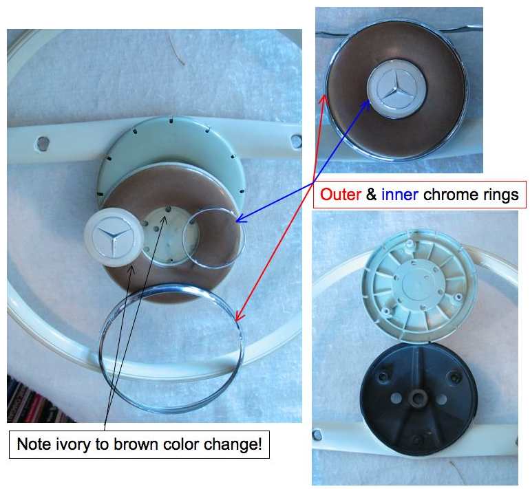

Type II – late 230 SL and 250SL
Horn ring: flat upper part with 2 pins through the crossbar
Wheel: grooves facing driver and 5 single holes on the inner side
Center pad: Outer ring: 2-part - outer half facing driver is chromed and inner half is painted matte dark-grey/black.
Inner chrome ring around plastic center star.
Download Attachment: 230SL-1.jpg
62.91 KB
Download Attachment: 230SL-2.jpg
52.59 KB
Download Attachment: 230SL-3.jpg
69.32 KB

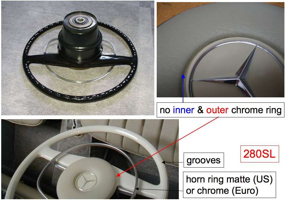

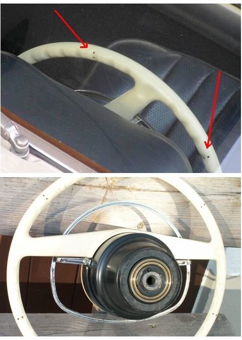

Type III – 280SL
Horn ring: flat upper part without pins
Wheel: grooves facing driver and 5 pairs of holes on the inner side Center pad: No outer and inner chrome rings
Center star is surrounded by a chrome-mirrored ring within the plastic.
Download Attachment: 280SLpad.jpg
79.06 KB
Download Attachment: 280SLstwl.jpg
53.36 KB

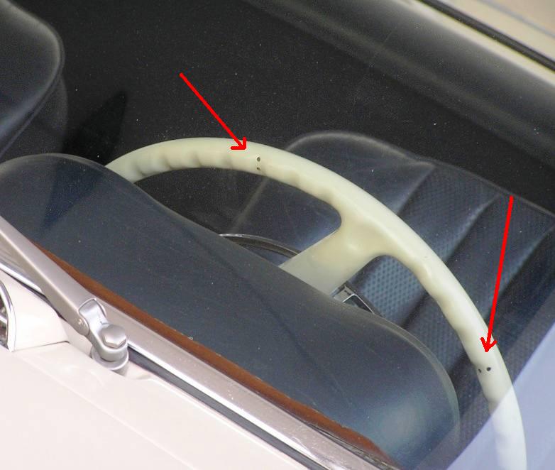

Download Attachment: Rim_holes.jpg
56.8 KB

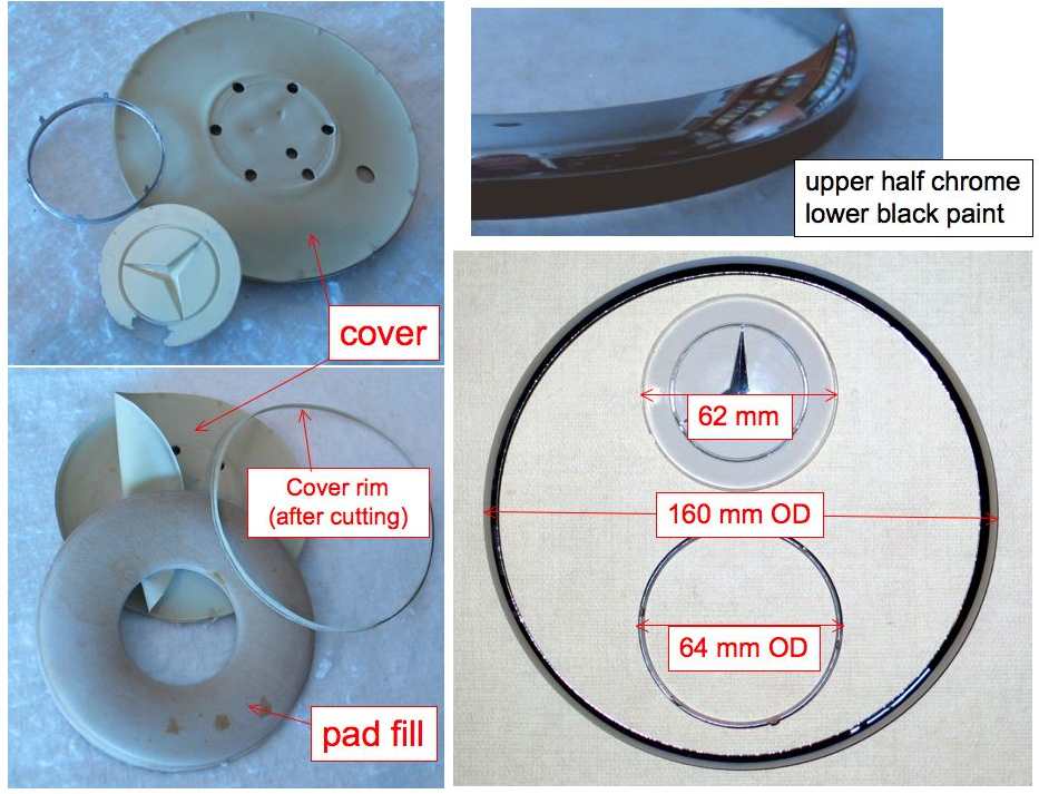

For those who need to refurbish these wheels and pads it appears that the 230SL and 280SL plastic center star have the same diameter.  So if the inner chrome is still good one can put a 280SL star into the center of the 230SL pad.
I don't have the OD for the 280SL pad and therefore dont know whether it will fit into the outer ring of the 230SL pad.  Perhaps somebody can supply the missing information.
If the padding cover needs to be replaced then it is easiest to use a razor blade, or scalpel, and to cut the pad out of the outer chrome ring. The cut cover (see picture) can then be pulled through the center of the donut without damaging the briddle padding.

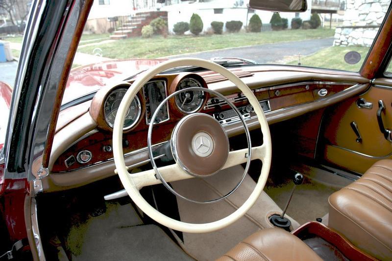

Naj sent me pictures that he took of a 230SL at a meeting in Germany, claimed to be original with 1.2 million km with unrestored chassis and interior.  The wheel rim clearly has no grooves and the horn ring is round. But what about the pad and the center star?   Do they look original to you restorers and originality experts out there?  I cannot see a chrome ring around the plastic star next to the pad.
Download Attachment: OriginalType1.jpg
67.86 KB

Alfred,
  Are you talking about these tiny holes in the back of the steering wheel.
Download Attachment: PB110120s.JPG
56.22 KB

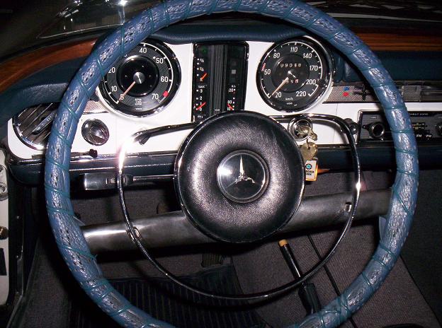

Hey Alfred, very informative stuff. I don't really have much to add -- except I have always wondered about my steering wheel. Obviously it should be the early variety (#871). However, I have the flatter horn ring like the later 230SL. So one would assume not original...
But judging from this info -- my wheel may still be an early one: no grooves on wheel (trust me I looked), and the center pad outer ring is all chrome. Perhaps to first owner just changed out the horn ring (for better visibility?).
Download Attachment: wheel.JPG
77.89 KB

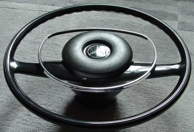

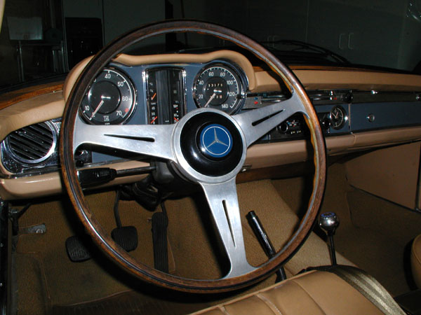

I believe that this was an option.  Nardi - wood with steel spokes - black horn surround with white star on blue background.  '65 230sl (5783)
Download Attachment: P1010001small.jpg
84.75 KB

Hey Deacon -- nice interior. Yours is the first Pagoda with what I think is the same kind of shift-knob I have (and I've seen a lot of Pagodas  :) )...

Thanks Abbas!
I changed my text to indicate that the Type III wheel also has those little holes. Although I am curious, do they come in pairs, or is this an image/reflection problem? On the Type II there are several single holes only.

Deacon, looking only from the front, are all the Nardis for later Pagodas the same as yours?

66&Blue,
I have no idea what later Nardi's look like.  I've never seen one.  I guess it's best to just ask if others have them and what they look like.
Need any other angles?

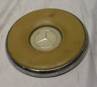

Does your outer chrome ring look like this? It is from a W108/111 and supposedly is the same as the early 230SL.
Download Attachment: W108_W111hornpad.jpg
27.04 KB

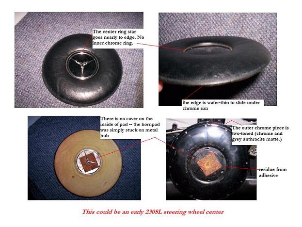

Re: Steering wheels & horn pads Tour
« Reply #14 on: February 10, 2007, 13:53:29 »
Alfred, I went out and took a closer look at things. I don't think my hornpad looks exactly like the W108/111 photo you provided. Nor does it match up much with those in the Tour. Some of the things I observed are pointed out in the photo below. I am not 100% sure it is what the early 230SL had -- so I hope others will chime in.
Download Attachment: 63hornpad.JPG
53.05 KB

Abbas and Joe, thanks for the accolades and Rodd thanks for changing the  topic title.
I have added the picture showing the holes in the Type III wheel but would like a confirmation that there are indeed 5 pairs of holes and not 6. I cannot quite determine that from the pic that I found.
{I wonder why M-B had to add another hole to fabricate the wheel.}
