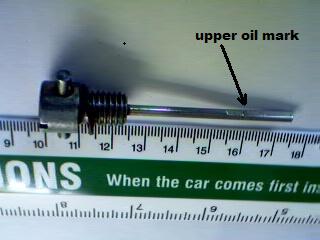

Hey Mike,
Do you mean 4mm ?
The reason I ask is that the whole reservoir would be full of oil with possibly some almost flowing on to your garage floor.
I attached a pic of the dip stick showing the upper oil level.
If the oil smells ok, I would adjust it to the correct level.
400 miles a year, gee I can't stay out of my car on the weekends.
Download Attachment: InjPumpOilDipStick.JPG
14.01 KB
dimensions are in millimeters
I second the motion.
