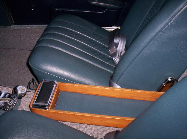

Question, look at the attached pic.
Download Attachment: 113cpt.jpg
24.47 KB
Should the small piece of bound carpet be installed under the center wood tray vs just laying in the tray?  They may just picture it this way to show all the carpet pieces?
My center tray has always been a bit unstable and with the carpet installed underneath, I would think it would provide more stability to the tray.
What is the correct installation?

I understand that this carpet sits nicely in the wooden tray. It is that way in my car at least.

I believe the carpet piece should lay in the wooden tray, sort of a like a place mat. Mine does not have a second piece underneath the tray.
I do understand what you are talking about,in the way the tray is mounted, not really an integrated set up, like the 107's etal.

It's supposed to sit in the tray. The later 280 SLs have the multi-loop carpet insert; earlier Pagodas, including the early 280 SLs, have a piece of vinyl that rests in the tray. (Can someone give a VIN for when that change happened?)

My 280, #01484 has the vinyl piece in the console tray. Change obviously came later.

The center tray is screwed to two raised brackets located under the carpet.  To make the tray more stable I placed extra Dynamat to the surrounding areas level with the bracket tops before glueing down the carpet.  The extra carpet piece than fits into the tray.  Mine is just a little short 1/4 for the box.

I checked and I do have the 2 brackets.  I guess with the carpeting on top of the brackets, it rounds the edges off and thus makes the tray unstable.
When I replace my carpet, I will try what Bruce suggested with some extra mat material.  Another idea would be to simply trim open the top area of the brackets, expose the brackets and place the tray directly on the brackets instead of the carpet.

my old (original) carpet was installed almost as you describe. The backing was scribed showing a very narrow "X" - about the with of the bracket - but not cut all the way through. This allowed the carpet to be somewhat molded/stretched to the contour of the bracket and provided a more or less plane surface. Also, make sure you have a cup washer under the screw that holds the tray because you really need to tighten down and don't want to split the wood.

Hey. I have had the carpet insert ever since I redid carpets in 1997. I don't recall vinyl in there previously but it may have started that way. Today I got creative with a scrap of MB-TEX. Tell me what ya think...
Before:Download Attachment: carpet.JPG
59.72 KB
After:Download Attachment: vinyl.JPG
54.43 KB
Re: Carpet - Center Tray?

Here's my anecdotal take on the console insert material: I've seen it in vinyl on the early cars and in a multiloop piece of carpeting in the later cars. The vinyl insert I distinctly remember on an original '68 cognac leather interior wasn't MB-Tex. It was a dark tan piece of really thin vinyl with very little texture on the surface. I'm certain it was OEM.

I'm actually with you Ed. The carpet lightens up the interior. But once I got the vinyl piece fitted right, it doesn't look too bad either. So at the moment, the vinyl is underneath, followed by my registration(s), insurance card, and topped off with the carpet...
Douglas, you may be right that the insert was more of a generic color -- in the case of the early 230's with my interior, the hornpad, cranks, and ashtray were a dark, dark grey rather than blue. Makes sense that piece was too.

Orginally their was only a peice of MB tex with stiching on both sides that laided in the center wood tray. I noticed alot of people change this to a peice of the carpeting with MB tex vinyl stiched around it. I am not sure this was a factory change or not? but to answer you question the center try was mounted over the console with either of carpet or MBZ tex in the center. I prefer orginal MBZ tex.

When I had the carpet replaced in my 250SL, I went with the carpet insert and put the vinyl piece away in storage.  In my opinion, the carpet looks better.  Plus, I can lift the carpet insert out and place the vinyl back in (which I haven't done since day one).

The vinyl is textured -- same texture AND COLOR as the window crank and ashtray vinyl inserts.  The tray insert vinyl has a small smooth edge along the outside.

Well...the tray vinyl piece is a rather smooth texture on mine (same as the window crank and ash tray vinyl inserts which never changed texture over the years).  The MB Tex on the 250SL and 230SL are the same and yes...this is even smoother than the tray vinyl piece.  The grainier MB Tex started on the 280SL and is courser than the vinyl on the tray, window crank and ashtray inserts.
