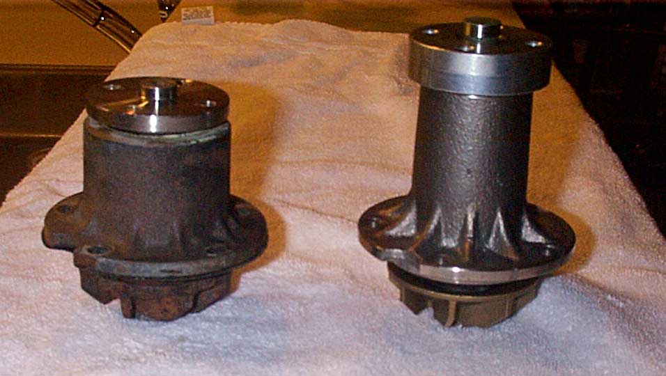

I replaced my water pump when I removed my air-conditioning.  With air-conditioning, you need the water pump with the shorter shaft/hub.  Without air-conditioning, the water pump with the longer hub is used.  Also, a different pulley is req'd based on which pump is used (with or w/o air).
Attached picture shows my old and new pump.

Thanks very much for the pic, Bob! Very kind of you...
I've concluded that mine is the short hub, but I'll be able to confirm this once I remove the pulley during installation. The pump is enroute... let the waiting begin!
